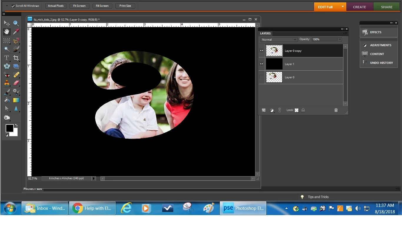

    Activate the cookie cutter tool, and within this is a library called "Objects." Within this is a shape called "Swirl." Rotate this 180 degrees, and it approximates the contour of the pinna.  You will have to play with it a bit to incorporate the salient portion of your picture before committing with the green check-mark

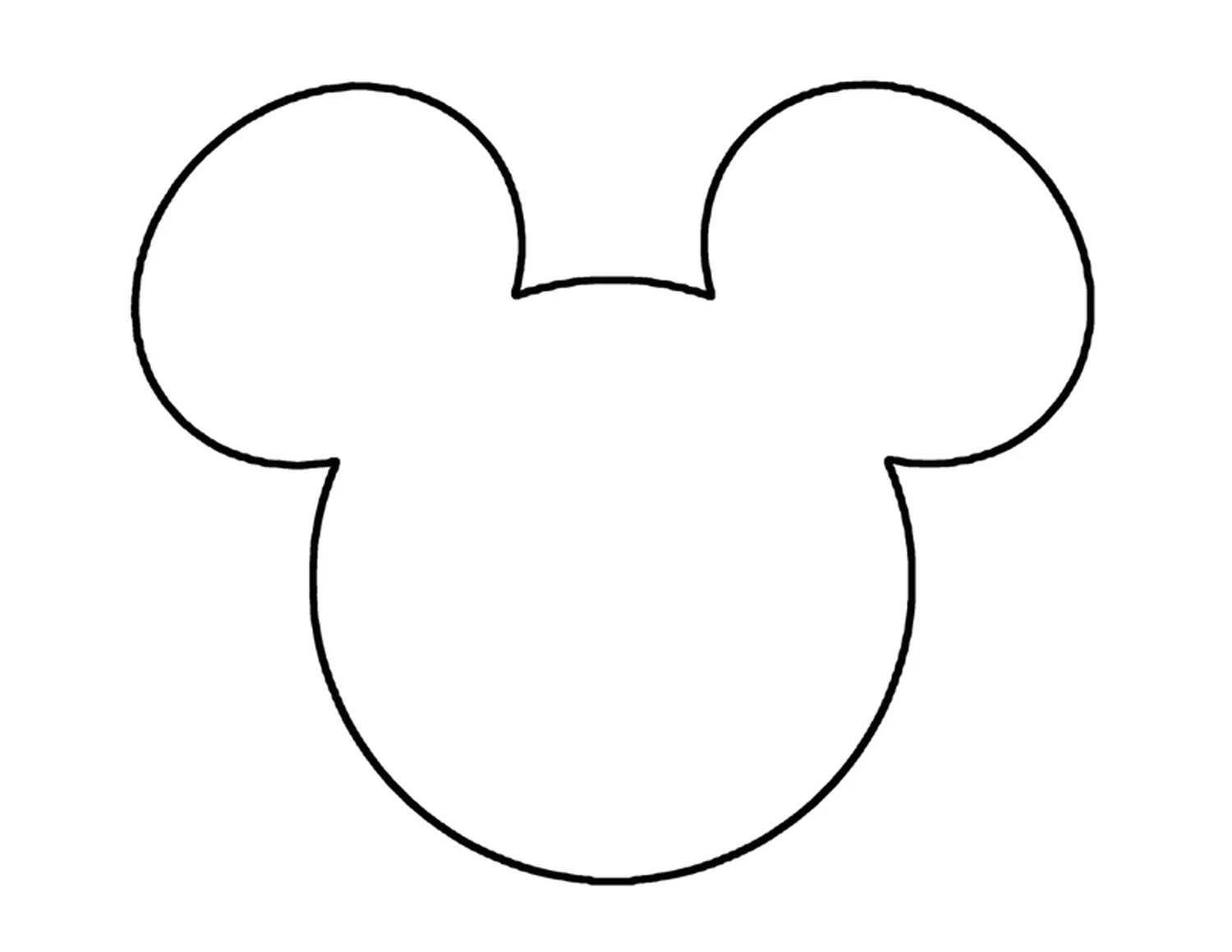

    If all you want is the head outline, do a Google or Bing image search on "mickey mouse outline".
    I found this one on white background. If you want to use it you can right-click to save to your PC.

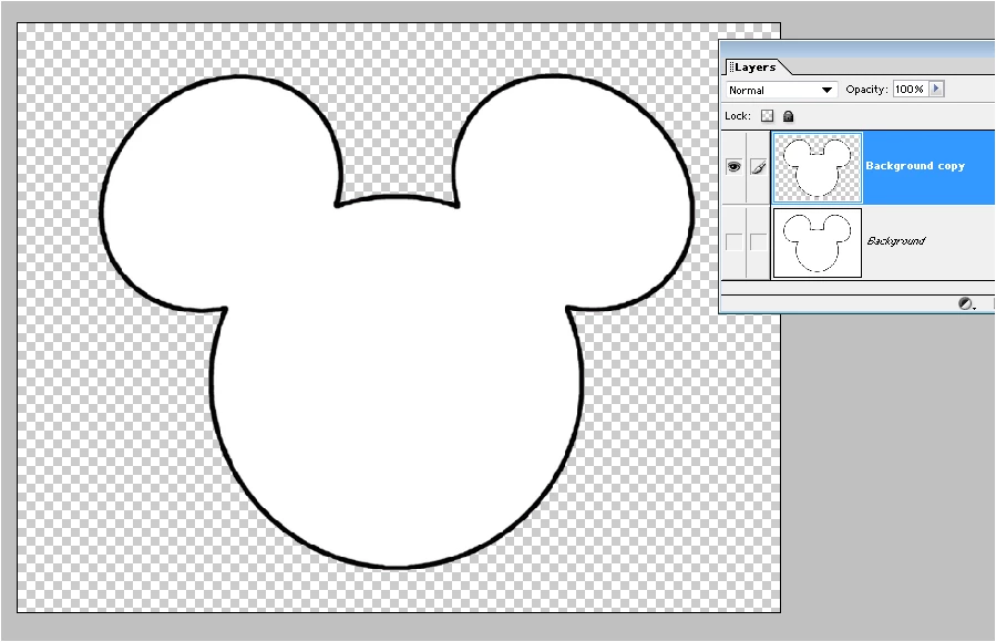

    After adding your pictures and text, to place the result on a t-shirt you will need to replace the white background with transparency.
    1.Duplicate the Background layer, and turn off the visibility of the Background layer.
    2. Activate the duplicate layer.
    2. Activate the Magic Wand tool with the Contiguous option checked.
    3. Click anywhere in the background to select it, and <Delete>. The background will be replaced by a checkerboard pattern indicating transparency.
    4. Save the file as a PNG, which preserves transparency. Note that if you save it as jpg the result will have the original white background.
