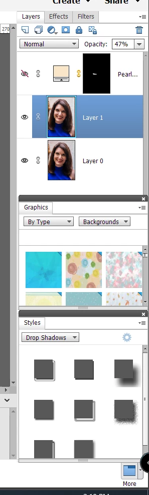

How can I open tools like Layers and Graphics at the same time.
In Expert mode of Editor, how can I keep the layers showing, whilst alos showing others such as graphics or styles at the same time.  I have PSE 2023.  Thank you.

Ian, the red dotted line you see in the article is to demonstrate the movement of the panel.
I have created a video tutorial which I have published to YouTube for you.  I hope this helps you figure it out.

Dec 29, 2022 6:56 AM UTC
Thnak you, that has cracked it.  I am sure it used to be easier in old versions.
I am also pretty certain that 99% of users will not know this and can be quite important.  It is not clearly set out.  Itis simply dragging the symbol.
Thanks again.

See this HelpX article.  It will allow you to arrange the panels something like this if you want.
Or you can have each panel floating.
Dec 28, 2022 8:07 AM UTC
Thank you for that reply, and the picture shows what I am trying to achieve.  But still the panel will not move.  I used to be able to do it in previous versions.  I do not get a red line along it as shown in the article.  I manage to open a panel and then get the headings as shown, but cannot go any further.  Thanks.
