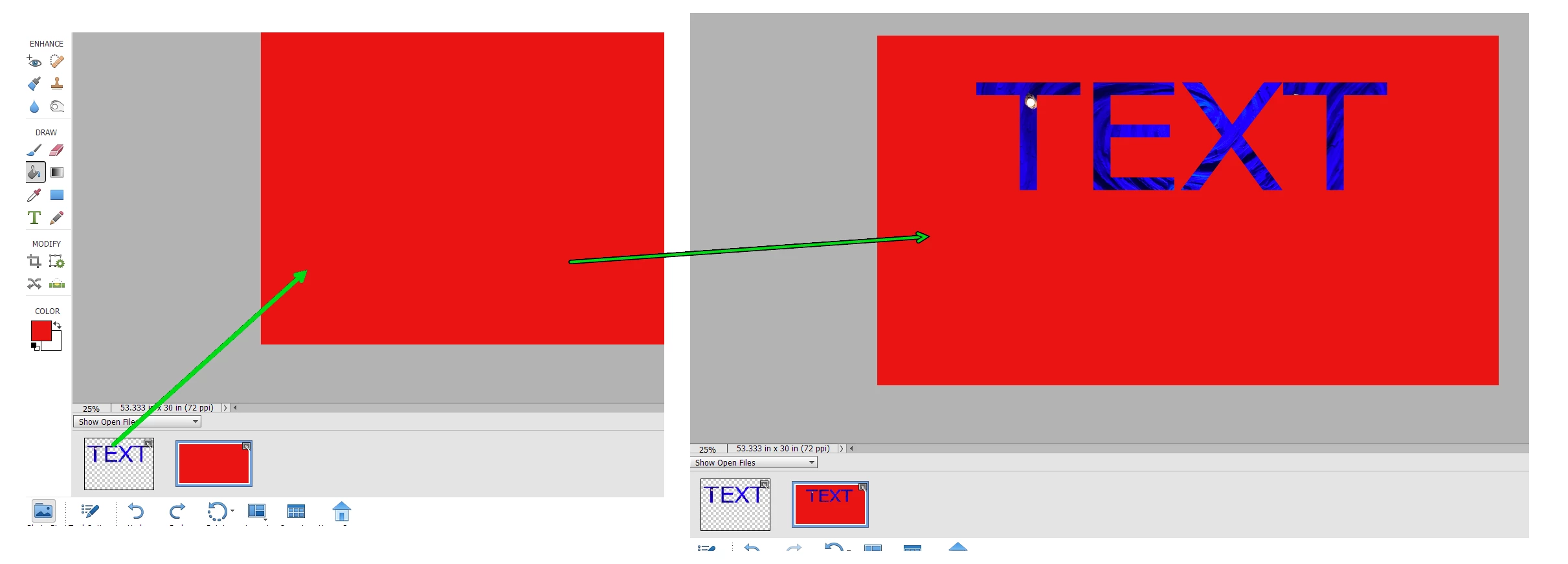

November 10, 2021
You should be able to drag and drop the title file into another document from the Photo Bin.
Alternatively, you need to merge the visible text layers, e.g. using the Shift+Ctrl+E shortcut.  You can then copy and paste the merged text layer into your other document.
There are various other commands that will do the same thing, but hopefully this takes care of your needs.

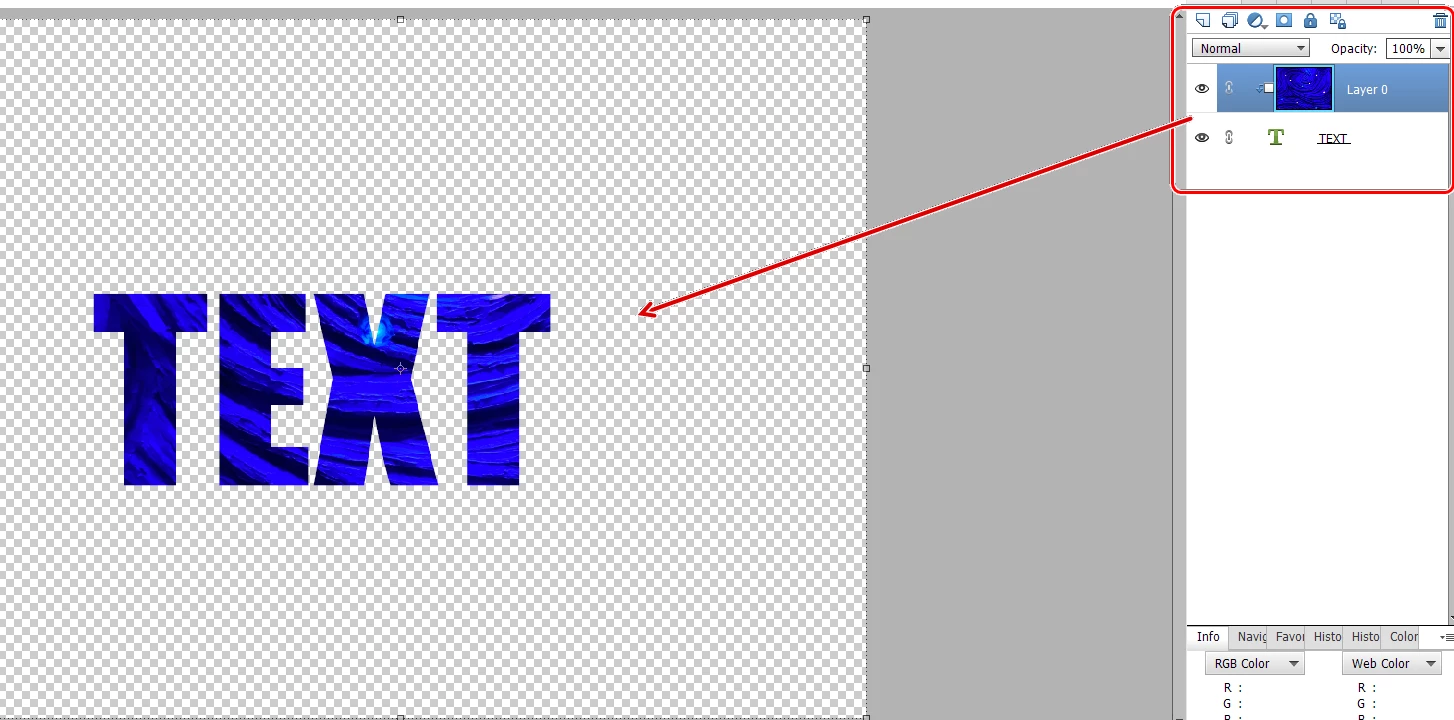

If I understand you correctly, you need to create a clipping mask:
  1. Create your text on a transparent layer.
  2. Place your patterned paper layer over it.
  3. Select the paper layer.
  4. Choose Create Clipping Mask from the Layers menu (or Alt+Ctrl+G).
RmcdonAuthor
November 10, 2021
That's actually easier than the way I used to do it.  Thanks!
