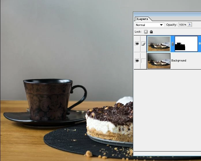

To restore the original, I added a Layer Mask.
Using the Brush tool with a small hard brush size, I painted with black on the mask those portions  to restore the original. You might want to zoom in close while painting the mask.
Note that if you paint too far, restoring for example the original shadow in the wall, you can paint with white on that excess to restore the lightness from the Dodge tool.
Tip: If you set the Foreground/Background color swatches to their default black/white values, you can type "x" while painting the mask to toggle between black and white.
Here is the final result if you wish to save it to your PC.

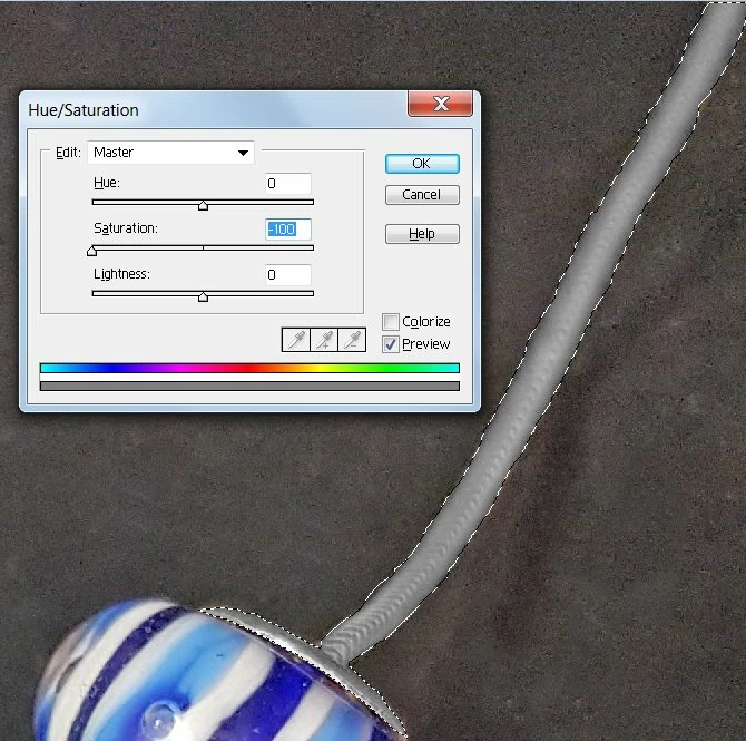

September 18, 2017
From the look of the bottom portion of the chain on the left side, I'm guessing it is a silver chain.
If that is the case:
Here I used the Magnetic Lasso to select the right portion, then smoothed the selection 5 pixels.
Then applied a Hue/Saturation adjustment where I moved the Saturation slider all the way to the left.
Did the same on the left side.  Final result:

September 18, 2017
Natasha,
I don't have PSE15, but I'm guessing you have to be in Expert Mode to access it.
If you want, you can right-click my result to save it to your PC.

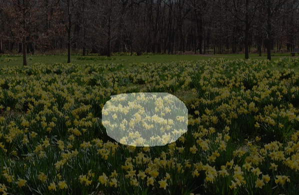

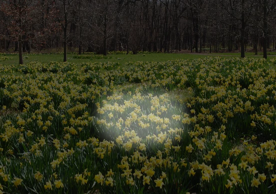

April 3, 2017
Follow-up to the selection method in msg#1:
You might want to feather the selection before applying the adjustment.
Here is with the selection unfeathered:
Here I feathered the selection 70px.
Of course the amount of the feather depends on the picture's resolution. A matter of trial and error.
