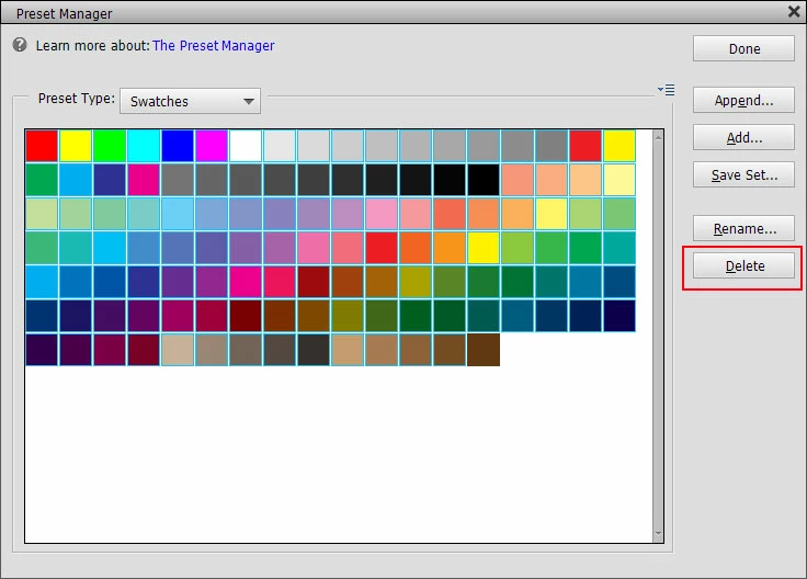

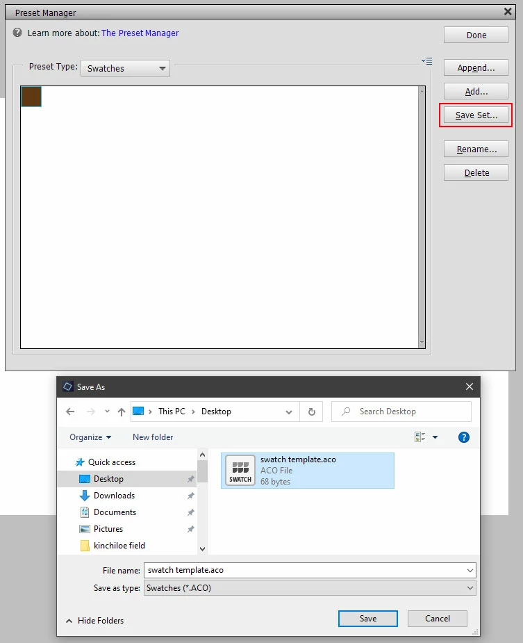

In the Expert mode you can go to Edit>Preset Manager>Swatches, click the first swatch then shift click on the next to last swatch and click Delete. Then click on the remaining swatch and save out the swatch as your blank swatch file that you load any time you want to make a color swatch library. (there has to be at least one swatch in a library or you can't save it)

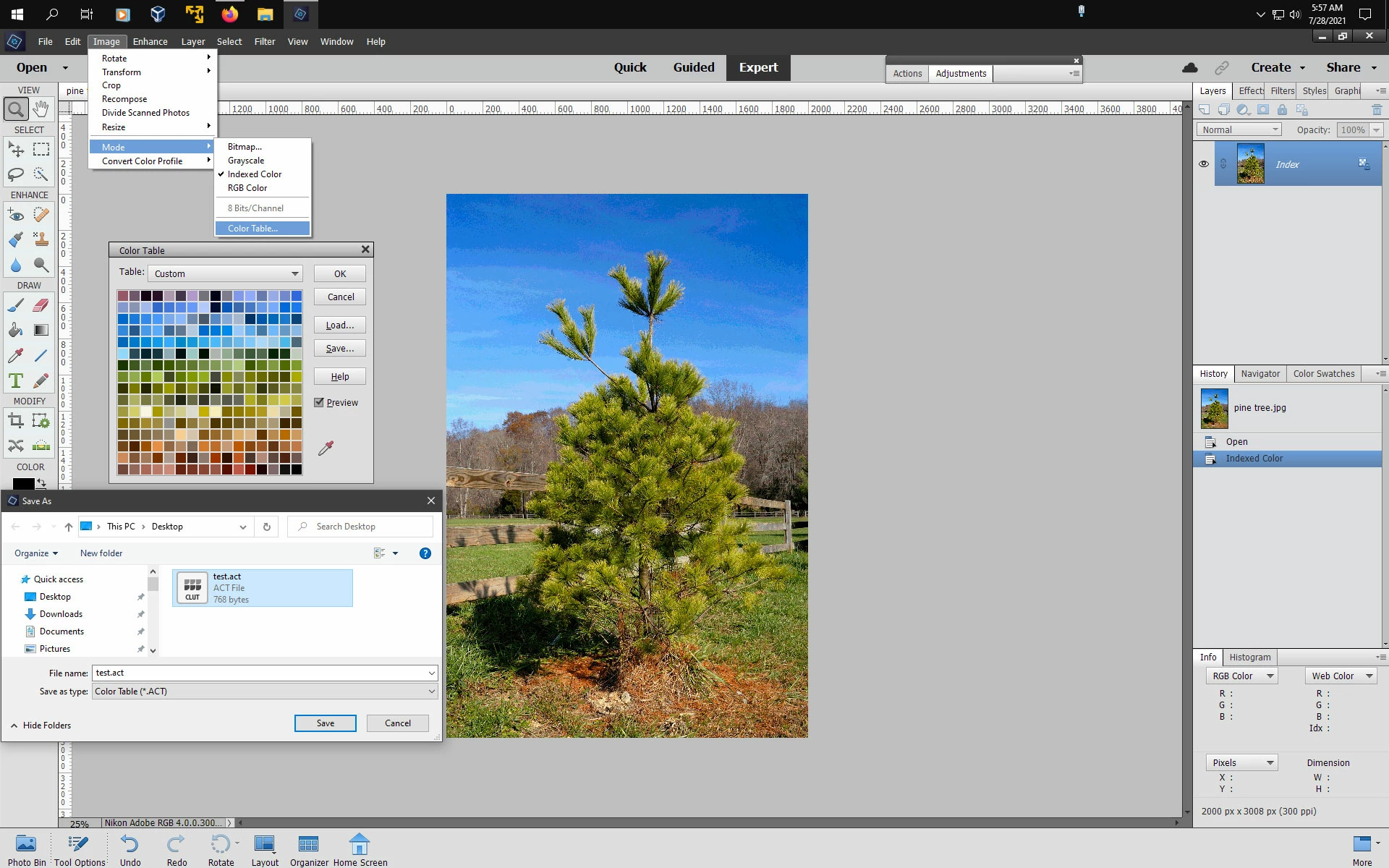

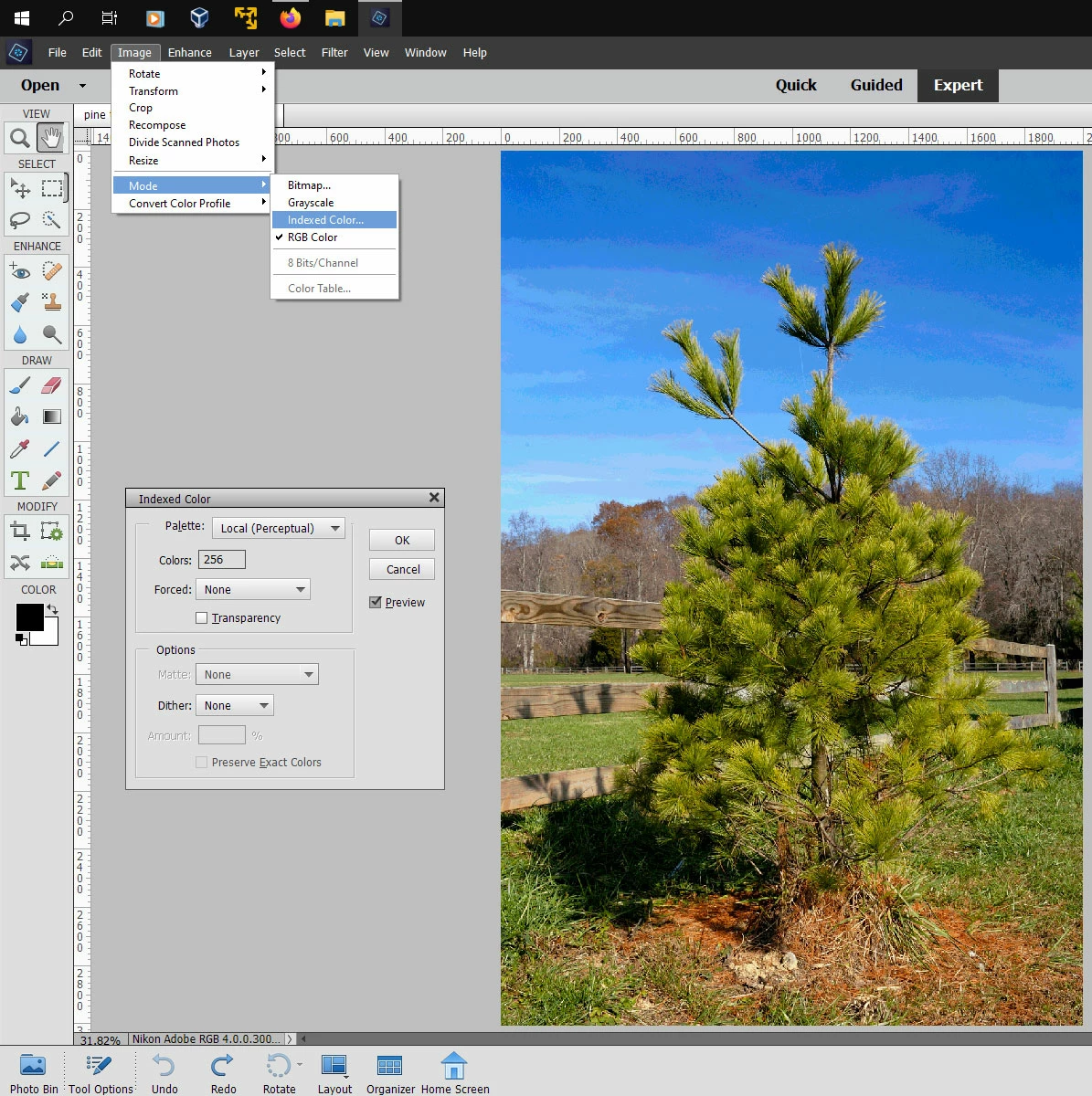

You could also convert your image to Indexed Color Mode (Image>Mode>Indexed Color) to get a variety of colors from your image. Then go to Image>Mode>Color Table and save out the file as an act (color table) then load the act file into your swatches panel.

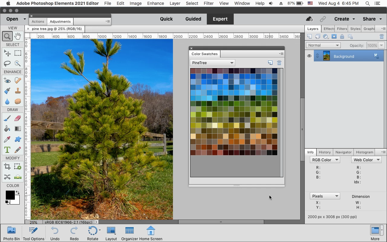

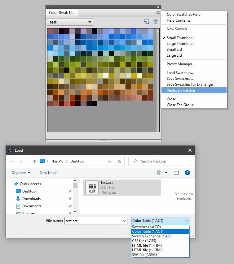

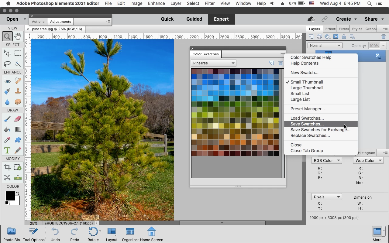

Jeff Arola
August 5, 2021

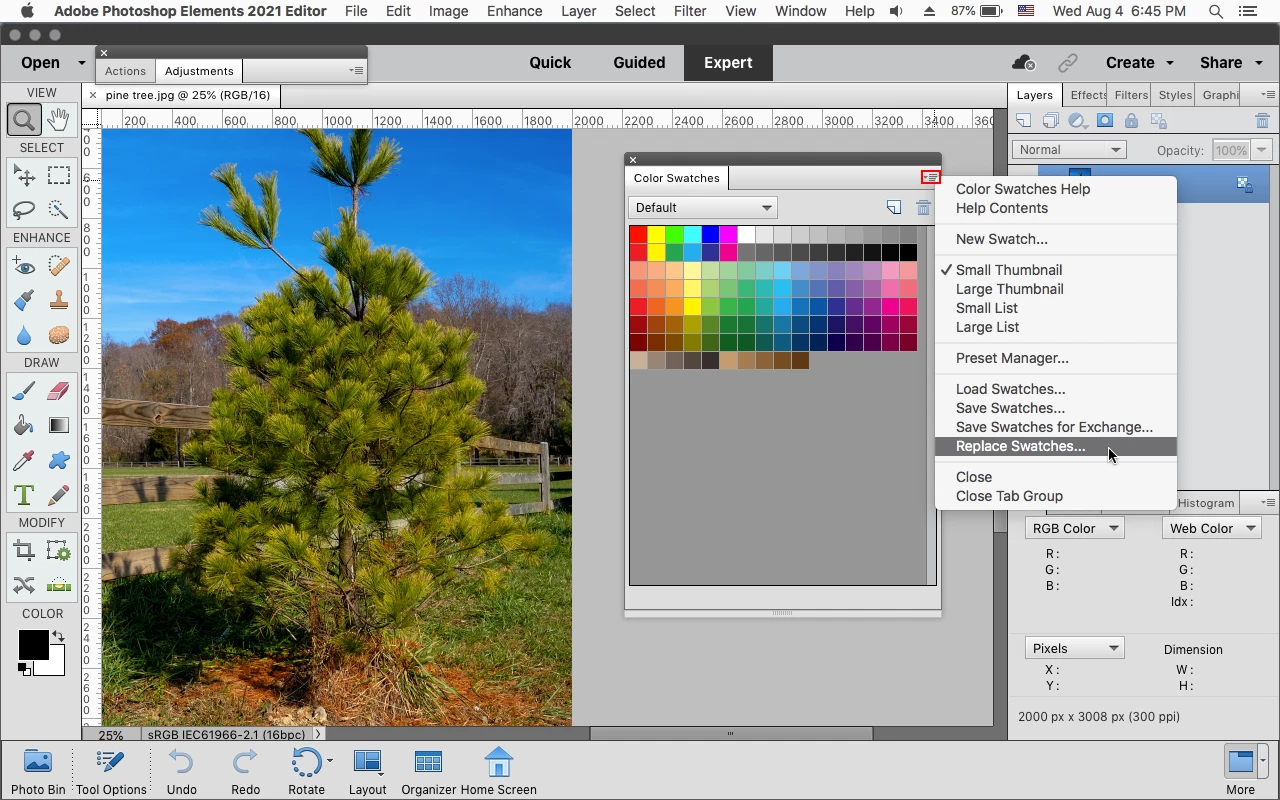

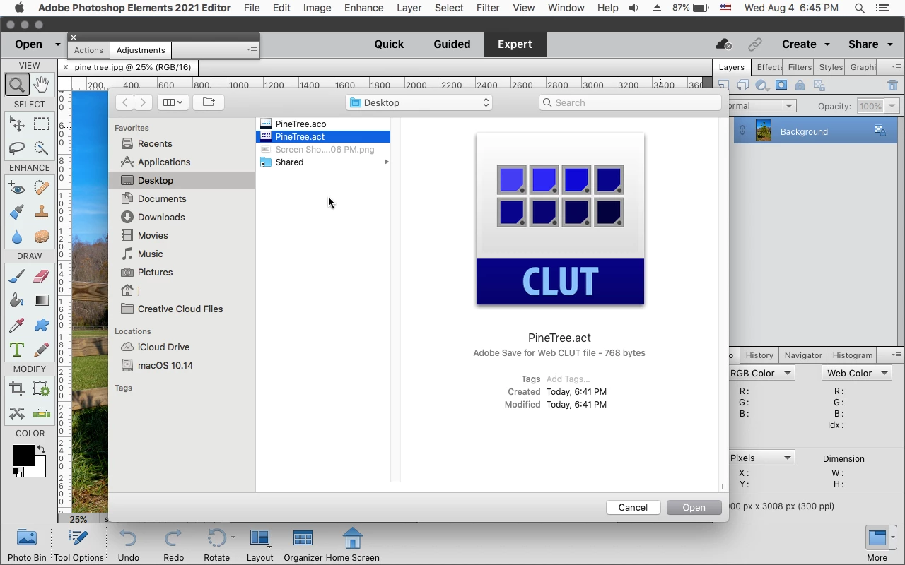

You should be able to open .act files from the Swatches panel
Then you can save the Swatches as a .aco file.

Jeff, first, thanks muchly ... but when I follow your instructions, I can't "Save Set" -- I don't get the "Save as" screen -- I only get the "Done" option, and when I select that, it goes away.

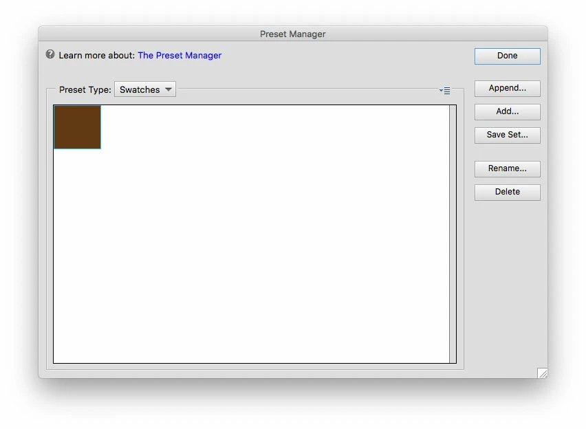

Jeff Arola

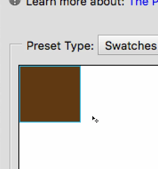

July 28, 2021
Before the Save Set will work, at least one swatch needs to be selected by clicking on it so you see a small blue border around it telling you it's been selected.
