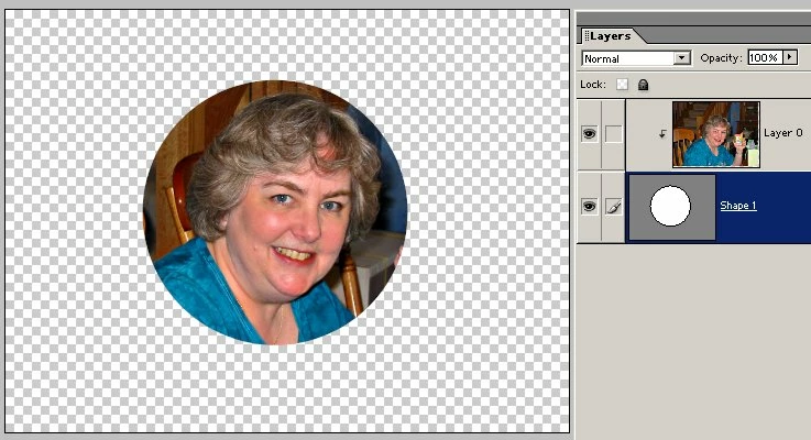

    Next, active the Elipse tool.  Holding down Shift, draw out a circle approximately the size you want (Shift forces the ellipse to be a circle). This creates a new layer named "Shape 1". Don't worry that the circle is a solid color and not in the exact size and position you want; we will fix this is a moment.
    Move the shape layer below the picture layer and group the 2 layers.The picture will now be cropped into the circle, with a checkerboard background indicating transparency:
    The nice thing about this method is that you can now resize and reposition the picture precisely where you want it within the crcle.  Select the Move Tool and with either layer activated use the mouse and/or arrow keys to reposition the picture. To resize the circle, with the Move tool selected activate the picture layer and while holding Shift drag any of the corner handles to resize (Shift preserves the circle). If you want to reposition the circle-picture combination within the picture's canvas, link the 2 layers and use the Move tool with mouse or arrow keys.

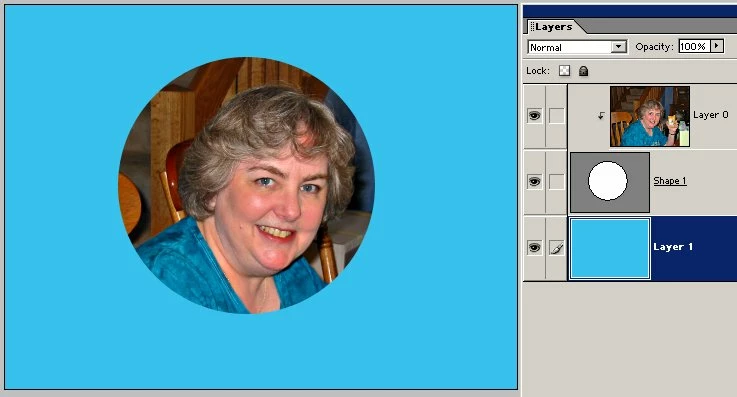

    If the picture is to be used for an application that requires transparency (such as MS Word document, Web page, greeting card program), save it in a file type that supports transparency. PSD, TIFF, PNG, GIF, EPS support transparency.  JPG, BMP do not. If you save it as jpg for example, you will not have transparency but instead a white background (which is maybe what you wanted in the first place). If you want a different color background add a blank layer at the bottom of the stack and fill it with your color:
