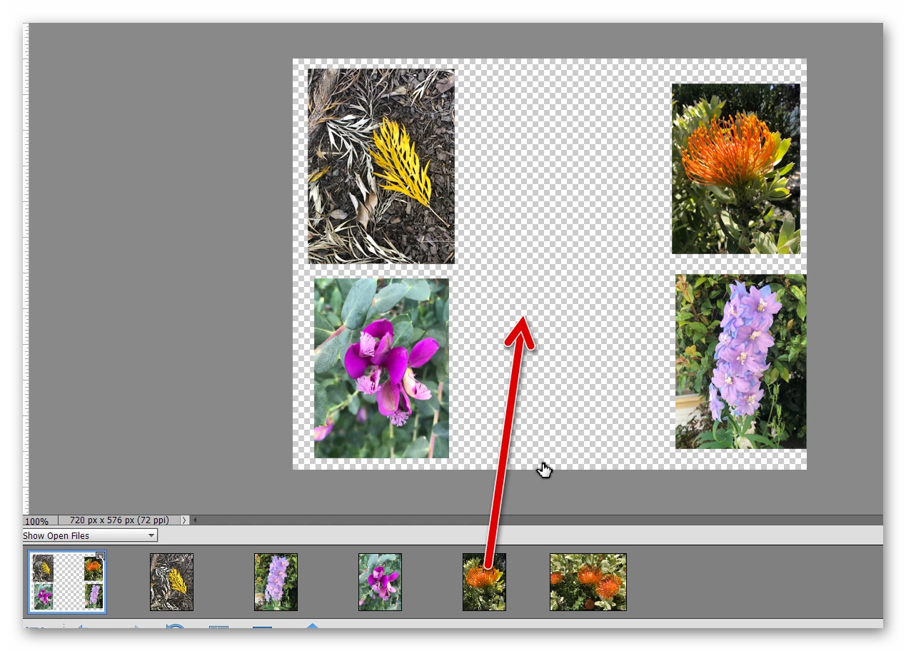

Greg_S.
June 18, 2020
  1. Create a new file in the Editor according to your desired resolution. (Set the background color to your choice.)
  2. Open all of the files in the Editor that you wish to place in the collage.
  3. Select the new file from the Photo Bin.
  4. Drag and drop your collage photos from the Photo Bin to the new file.
  5. Using the Move tool, select the handles around a photo to resize and locate the photo in the collage.
