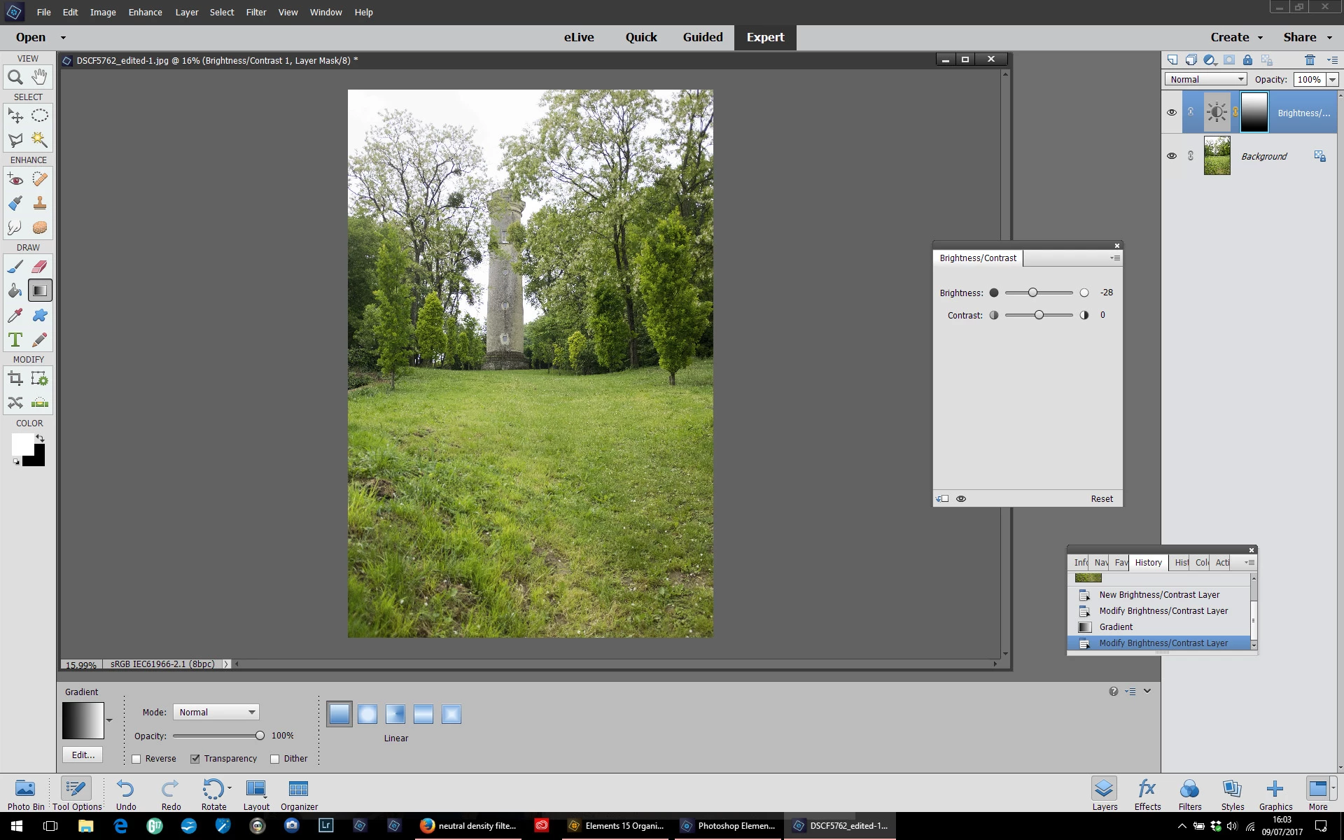

    Here is one way in two steps:
    1 - add an adjustment layer (brightness / contrast) and move the brightness contrast left (something like -30%)
    2 - in the layer palette, be sure the adjustment layer is active and Alt click on the mask on the right of the adjustment icon
    You should see a blank screen. Then draw a linear, black to white gradient from bottom to top (3rd gradient choice in the gradient tool)
    Alt click on the same mask icon to alternate on mask and image visibility.
    The original image is saved in the background layer. You can play on the settings of the brightness adjustments, on the adjustment layer opacity. The gradient can be drawn fully from bottom to top or from a middle point to the top.
    In this example, the upper part of the image is about 2 - 3 stops darker than in the original.
    Ask if you need more help for the gradient tool.
