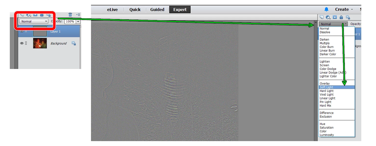

    Thank you for your response. I was able to follow the directions until I got to the step 7, which is the blending mode, which I am unable to find in Elements 13. Can you tell me where to find it?
    Thank you!
    January 11, 2022
    On the right hand side where it shows the background and the copy you made you will see a mini window showing the copy you can select and just above there it should have a drop down saying "Normal".  Select that to go to soft light or hard light.
