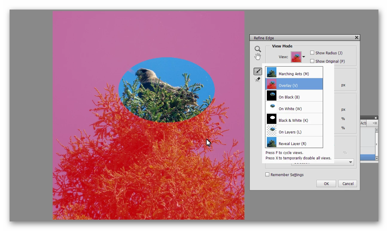

I also wanted to mention that it may help you visualize the selection if you open the Refine Edge tool.  There are various views of the selection that are available:

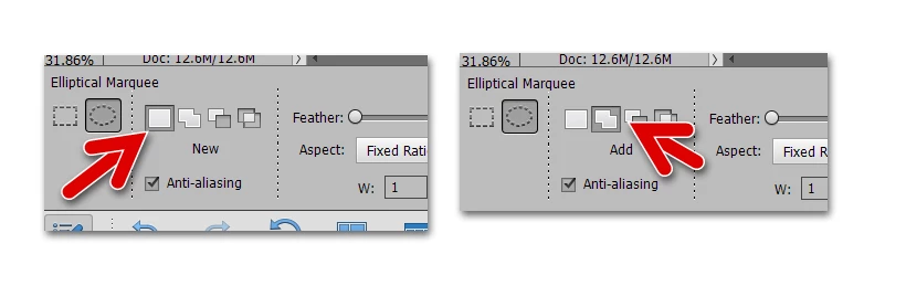

Again, I'm not sure what is going wrong here.  See my comment to your last question.  Also, if you are getting multiple selections but only want one, make sure that the selection tool is set to New selection, not in the Add to Selection mode.

-Multiple ovals in the "Fixed Size" was caused by being in "Add to Selection Mode" Now I am fine in the "New"
-Appreciate the tips on making the selection more obvious in the "View Mode"

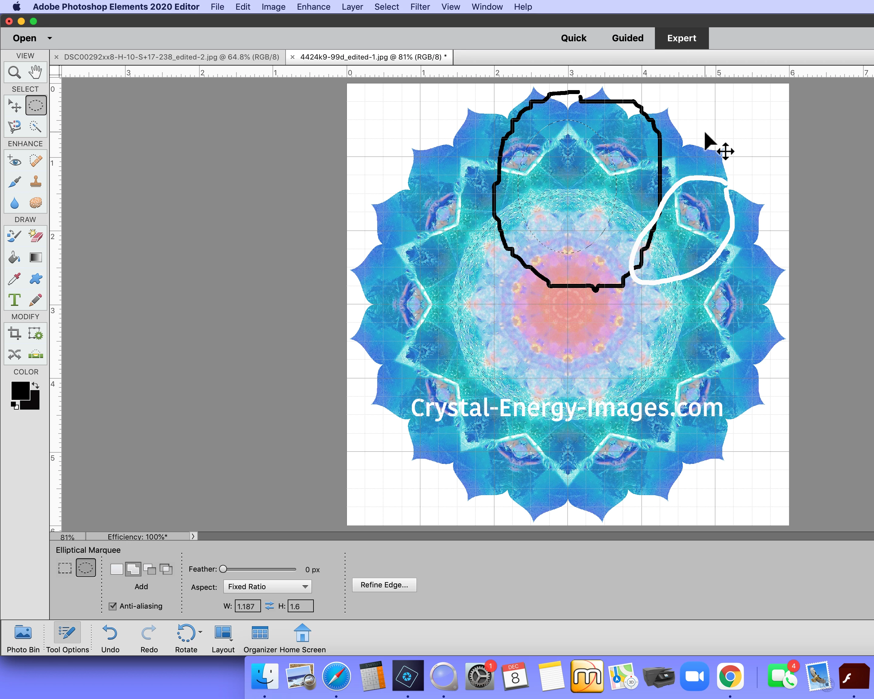

Thank you so much for your prompt reply! I do increase the image size. As you can see in the screen shot of an elliptical oval inside the black pencil, it is still diffcult to see. I greatly increased my cursor which helped. I have a 27 inch MAC screen
Even with the marching ants it is difficult to view.
Next...
Here is an example of a mandala that I designed. I make photo jewelry and need to isolate the oval section that I want to use. You can view the ratio setting on the screen shot. I place the oval on the mandala and it is in an upright north/south orientation. I know I can move with the direction tools rt., lt., up, down.
Ques.
1) Can it be tilted diagonally to isolate an area such as the white lined area? Or do I need to actually rotate the image first?
2) Can an image in the Fixed Ratio setting be clicked and dragged? Can't do it.
3) I can click and drag if in Fixed Size. However, I don't use this setting because it keeps making new ovals wherever I click, so Fixed Ratio is preferrable.
