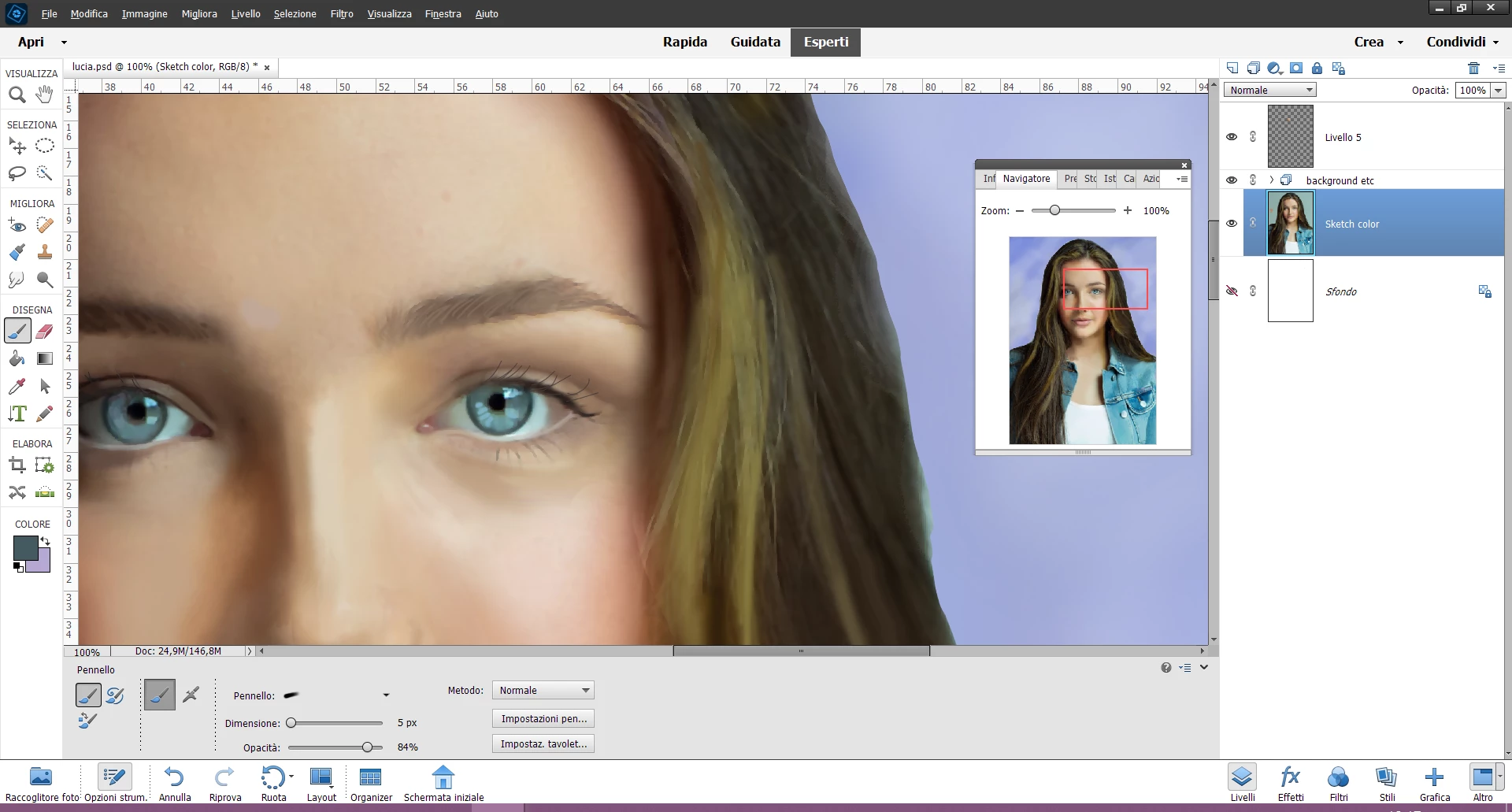

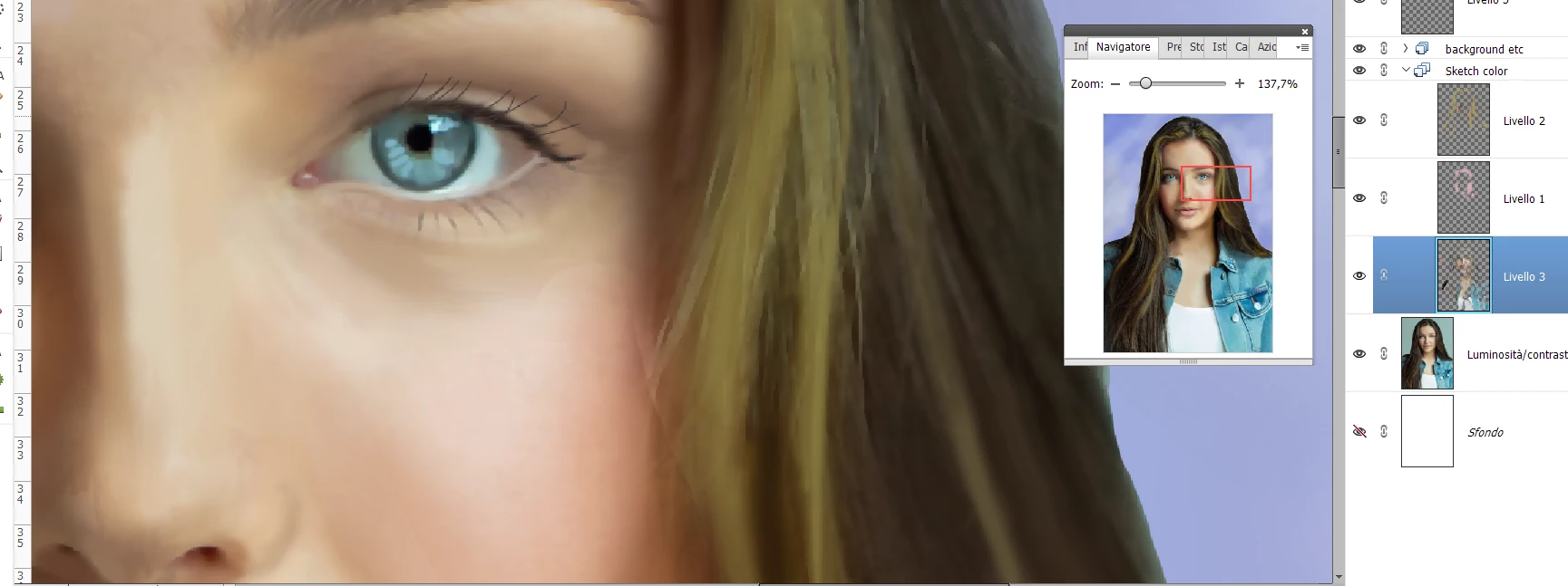

How to merge layers without change the image?
Hello, I have a question, there's a way to merge layers (CTRL + E) without change the image?
I need to put all layers in one and flat the image, leaving only the background and the very fist photo not merged.
I placed in the background a photo and with other layers I did some modification (adding lights and smudge the image)  in separated layers, one for example for hair , one for other details etc..)
After I finish adding lights and things I wanted to add over the original photo, I wanted to unite all the layers :
I selected all 3 layers and merge them with CTRL +E
But, it come out always in this way:
I would like the merge all layers, there's a way to have one single image, without this effect?
Thanks in advance for the help!

Valentina ♡
Aug 30, 2023 5:30 PM UTC
Thank you for the help.
Oh ok, in the case I need to flat totally the image, it's Shift + ctrl + e
In my case, I need to flat everything but not the original photo (in my document it's called "Luminosità/contrasto 1" and the background.
But I think is normal it appear in that way, as it merge only the layers with my brush effects/drawings/smudges modifications.

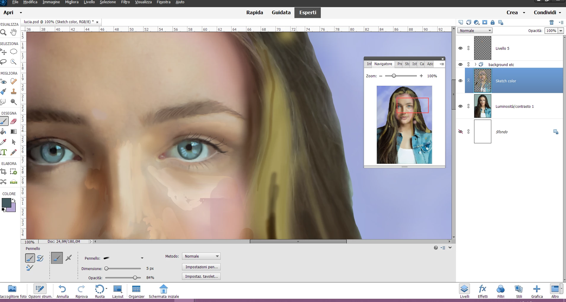

So, if I understood correctly:

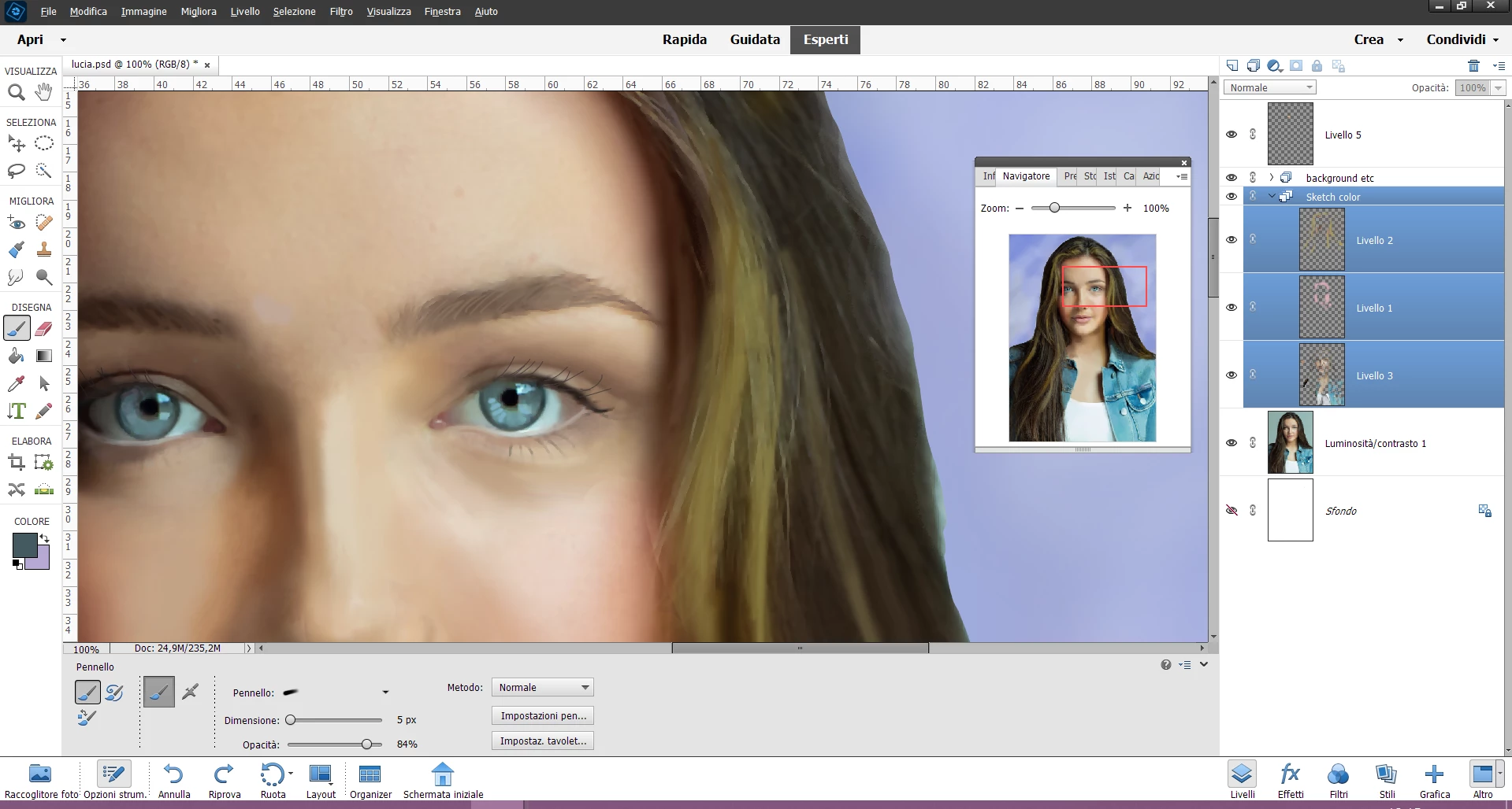

If I select only the layers of modifications:
(this is the 100% size of the document)  (ctrl + 1)
It will always come out on 'surface' only the modifications and these as are 'merged' now, they will  overlapping everything is in the layers below it:

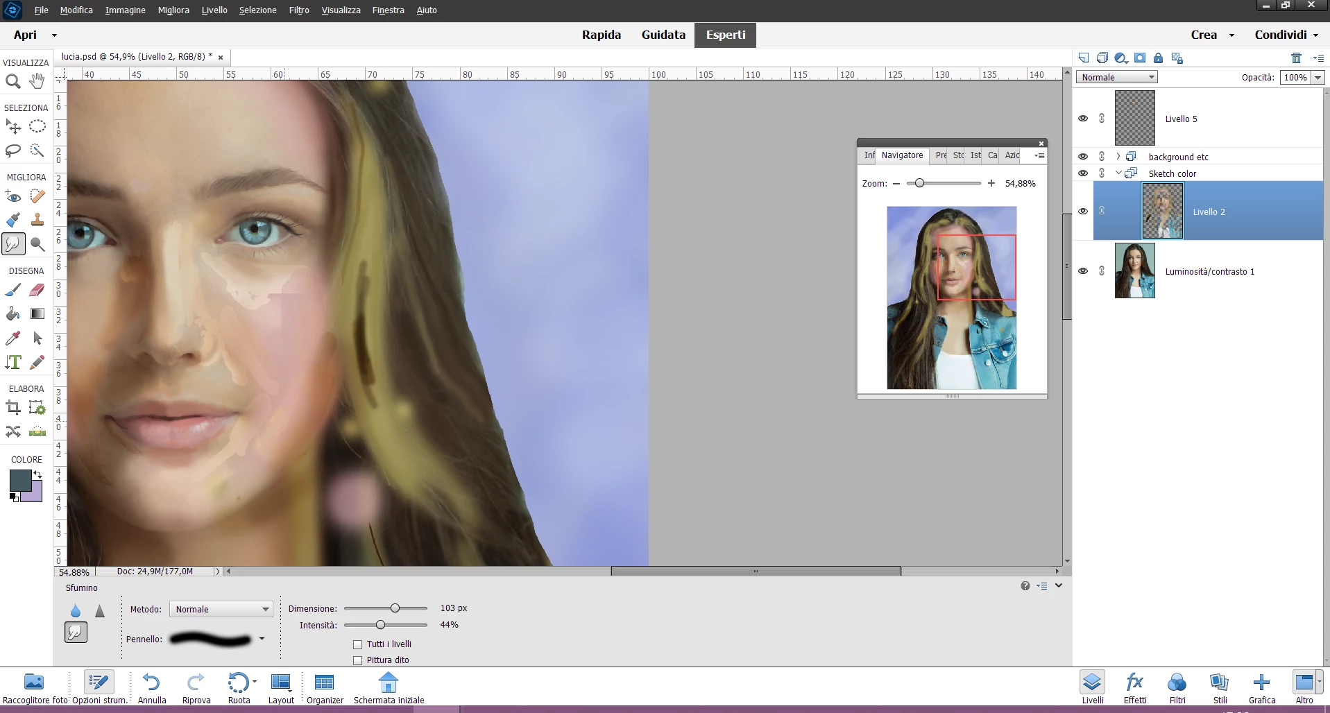

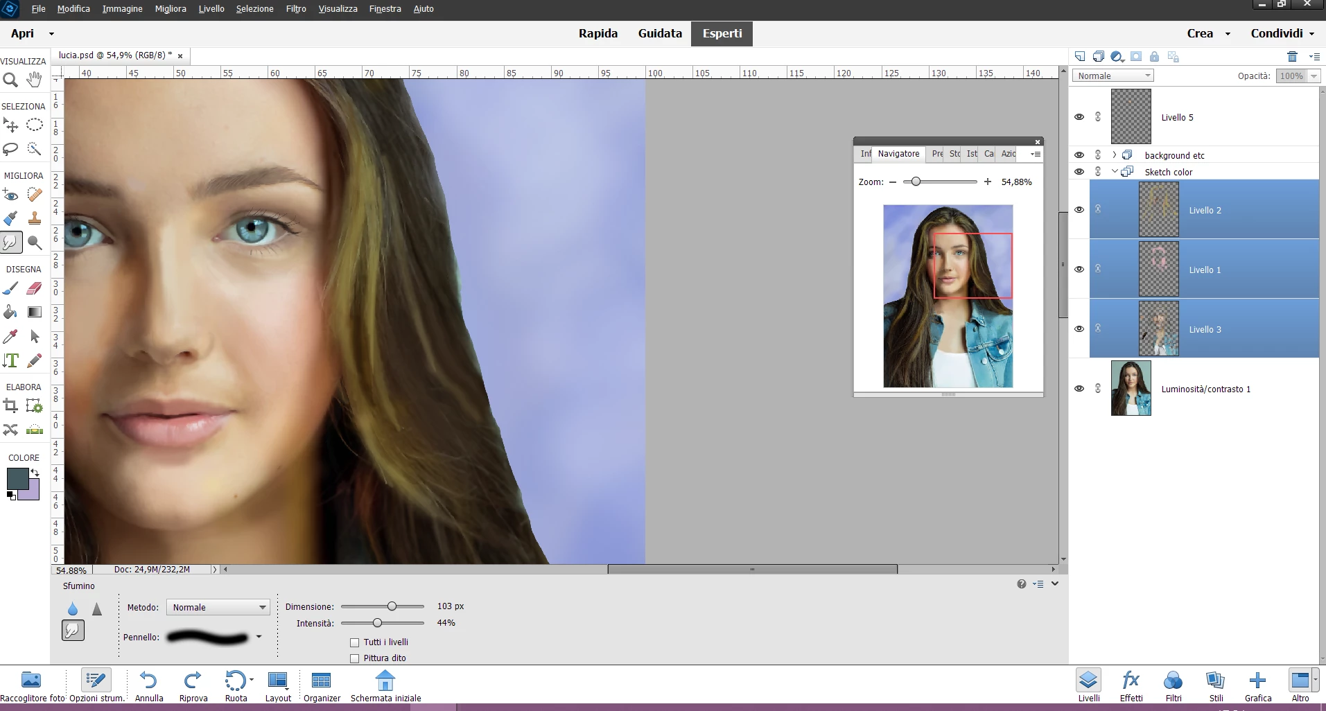

So the only thing I can do, is (if there is no other ways) is that I will select not only the layers with the modifications but also the first  image "Luminosità/contrasto 1" and then I will merge them:

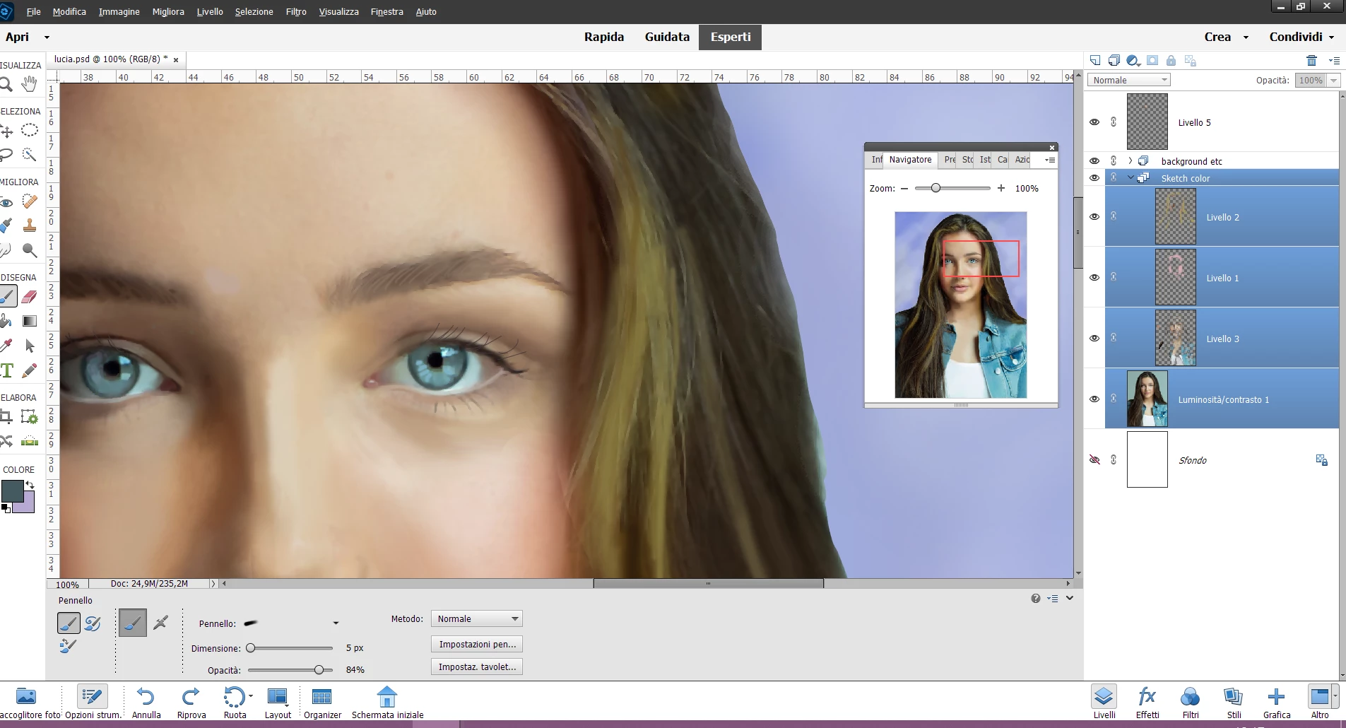

and that way, if I merge also the first photo, then it will be all merged together and it will not show the modifications anymore:
But since I need to preserve the first image as the original, then I think I will have to duplicate the first image, and then merge it with layers, so I will have the 'backup' of my first image that I want to keep (and deactivated this layers ) without modifications just for see as reference (before and after).
Thanks for the informations I will add in my notes also for other situations!
