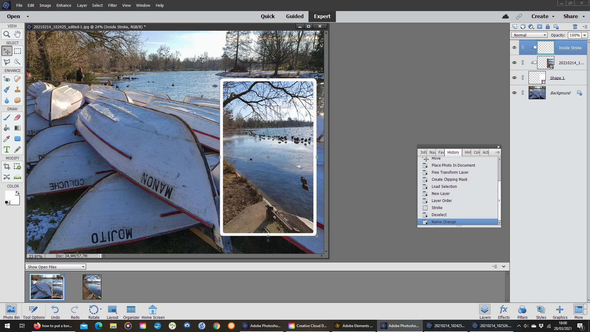

Maybe you want to add the white border as an 'inside stroke' of the placeholder?
Something like this:
Then it's important to first create a selection of the placeholder, here a rounded angles rectangle,
- create a selection of the place holder (Ctrl click on the incon in the shape layer)
- create a new empty layer to be clipped to the place holder
- move it above your target photo in the layers palette
- Create the stroke from the selection on the empty layer.
