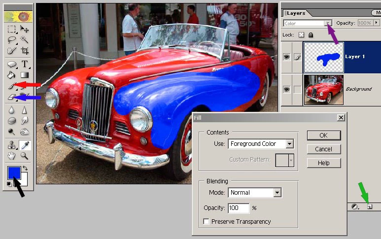

OK. Here is a snapshot showing everything I talked about and hopefully it answers you questions.
Keep in  mind that we have different PSEversions so things will look a bit different but the steps should be the same.
The green arrow is the icon in the Layers Palette to add a new blank layer. You can also do Layer > New > Layer.
The purple arrow is the Blending Mode pull-down list (default "Normal") and within this list select "Color". Next to it is the Opacity (default 100%) where you can lower the value to lighten the color.
The black arrow is the Foreground color. Click on this to bring up the Color Picker where you select your color (blue in my example).
The red arrow is the Brush tool. Activate this and paint the car.
Instead of painting you can select the car and do Edit > Fill. In the Fill dialog (shown in the example) select Foreground Color. If you are doing this on the blank layer (Layer 1 in example) you can leave the Blending Mode and Opacity values to their "Normal" and 100% defaults since the layer's values override these.  However if you choose to do the fill on the picture layer then you need to set Blending Mode to "Color" in the Fill dialog box (and optionally lower the Opacity).
Like I said before,  you are better off doing all of this on the blank layer since you can go back and tweak them, whereas changes on the picture layer are permanent.  Also, if you paint or fill too much on the blank layer you can use the Eraser tool (blue arrrow) to remove the excess.

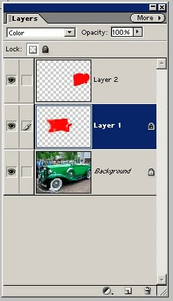

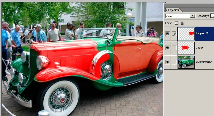

Add a blank layer and set its Blend Mode to Color. Then paint away. If the result is too dark you can lower the layer's Opacity. In thie example Layer 1 was 100% Opacity and Layer 2 70%. If the result is too light you can duplicate the layer and change it's Blend Mode to Multiply and lower its Opacity if necessary.
Of course you can do this directly on the picture layer by using the Brush tool with Mode Color, but this change is permanent.
Another advantage of the separate layer is that you can add a Hue/Saturation layer above it if you want to change the color again.

Blank  layer is Layer > New.  Also you can click the "Create a new layer" icon in the layers palette. In my PSE version 2 this is the middle icon at the bottom (the one with 2 squares). In your version it might be located elsewhere in the palette.
In my version the Blend Mode is the unnamed drop-down list at the top left corner of the palette. Again, it must be somewhere in your palette. When you add a new layer the default Blend Mode is Normal which when you paint would give a solid color.
"Paint away" means to set the Foreground color (red in my example) and use the Brush tool to paint on the layer. You can also select the area and do Edit > Fill and fill with the Foreground color.
