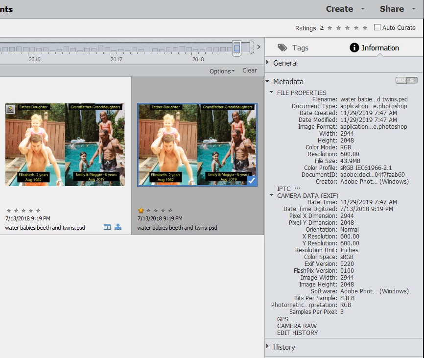

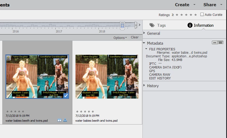

Organizer apparently created two thumbnails for the same file name.  One is a ghost with a reference to the old path name which you can see under INFORMATION | GENERAL on the right hand side of Organizer. But if you click on the METADATA tab below GENERAL you see it is virtually empty.  This thumbnail has a little yellow question mark in the upper left hand corner.  The other thumbnail references the correct path name and also contains detailed metadata. However, unlike the ghost, it does not have any tags that were previously assigned to it.  The screenshots below illustrate what I am talking about...
Ghost file (LHS)
Real File (RHS)
So you are absolutely correct.  I can delete the ghost and the original will be retained.
