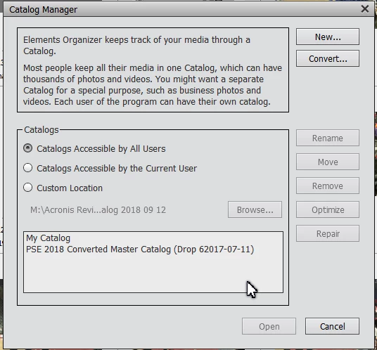

I am able to open the child folder without a problem.  The question (issue) is that I don't know how to open the parent media containing the 1800 media files.
issue -> how do I open the parent media folder which contains 1800 media files??
Correct answer Greg_S.
If you are truly talking about a catalog, go to File>Manage Catalogs.  If you have created the catalogs in the default locations, they should both appear in the box.  The "unnamed" catalog will probably have the default name of My Catalog.  If you did not create the catalogs in the default location, you will have to check the Custom Location radio button and browse for wherever you located the catalog.
If you still can't find the catalog, do a Windows search for a file called catalog.pse18db.  Double-click on the file and that will open the catalog.
