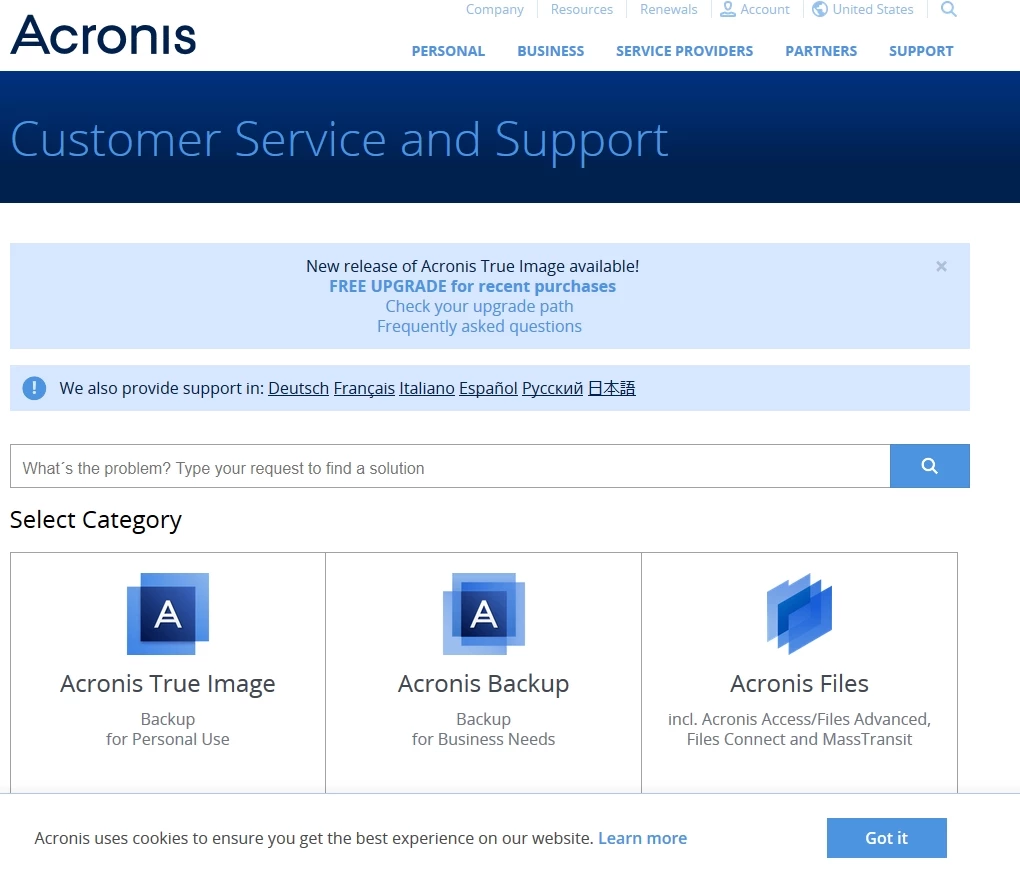

April 17, 2019
Hello david,
in my eyes you should better ask Akronis Customer Service at https://www.acronis.com/en-us/support/ >>> please see screenshot:
Hans-Günter
davids30539258
April 17, 2019
Hello Hans-G,
I appreciate the input.  I had already thought of that.  However, I know how to restore the Acronis files.  I have already restored all the files to another internal drive.  What I do not know is which files are required and where I should move them to in order for Photoshop Elements to find them and rebuild my catalog.
Greg_S.
