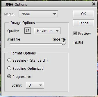

Hi rlt47,
I just edited a JPG photo in PSE 2020. I did the same edit that you did - a small spot healing brush edit. The size of my photo before the edit was 8.81 MB. After the edit, it is 10.6 MB which is the opposite of your result. When I save the edit, a "JPEG Options" window pops up for adjusting the size and quality of the photo. My options were set to "Maximum". Maybe you need to adjust the settings in the Options window.
This is a screenshot of the JPEG Options popup window.

Hi rlt47,

rlt47Author
Jan 12, 2020 3:19 AM UTC
Thank you for taking the time to check on that.  Using the "JPEG Options" window solved the problem for me.
