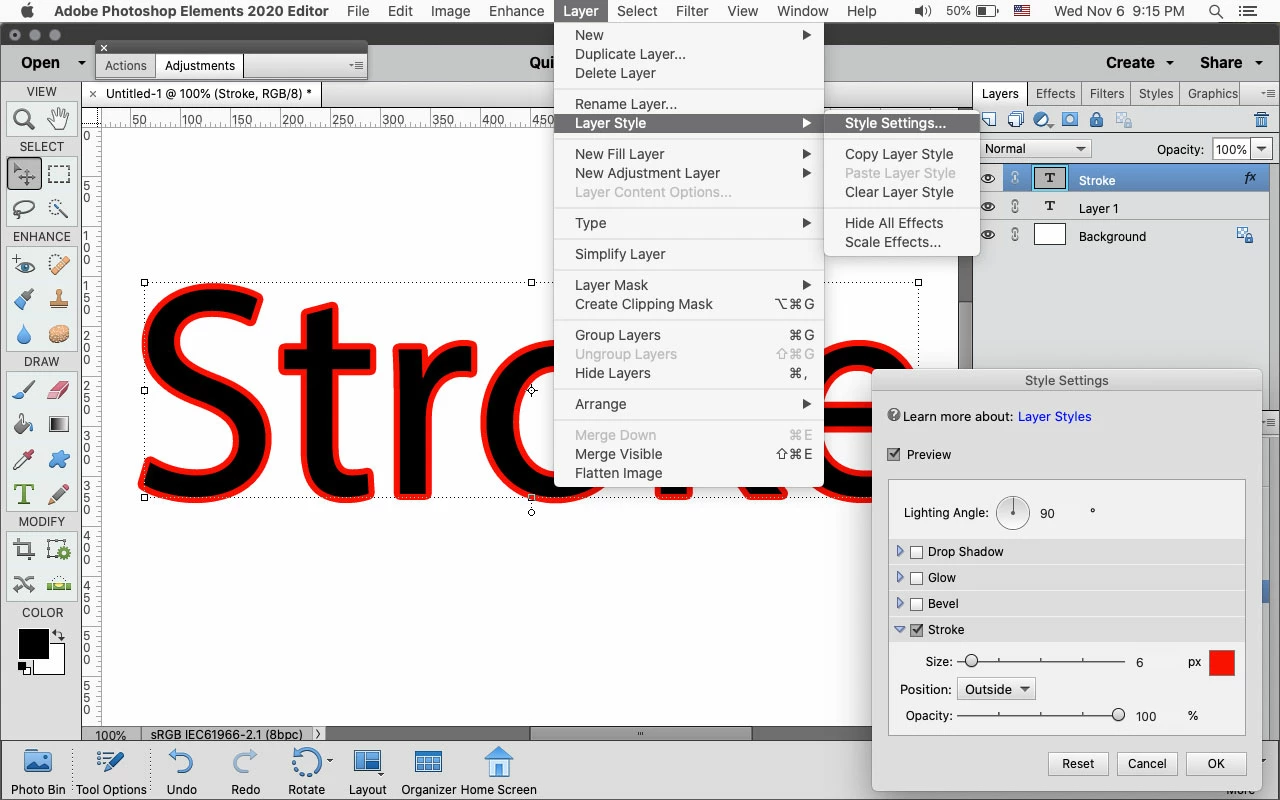

Correct answer Jeff Arola
In photoshop elements go to Layer>Layer Style>Style Settings, check Stroke and adjust as desired.
If you want to change the settings later, double click on the small fx in the layers panel to open the Style Settings.

Thank you! This worked the best and is easy to change.
aspen_p
aspen_pAuthor
November 7, 2019
However, although the default says outside, it is really inside. To get it outside you have to click on center or inside, then back to outside and it will really be outside then.

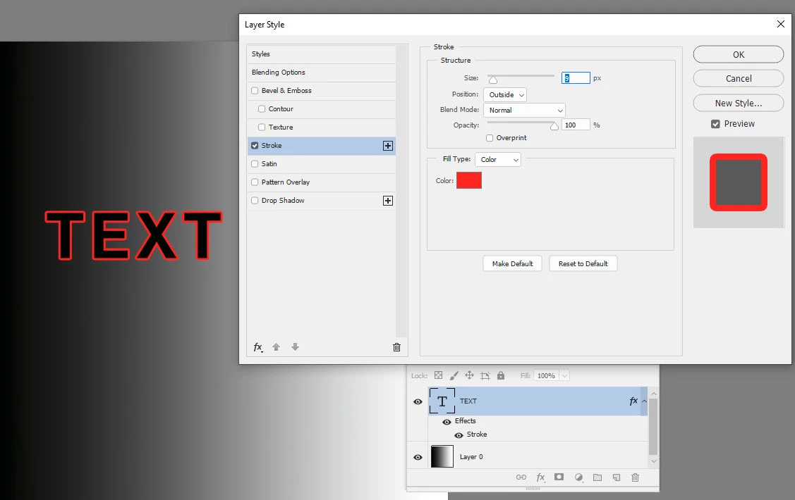

To add a stroke to text :
a. In the layers panel highlight the text layer and right click
b. In the menu that opens choose blending options
c. In the layer styles panel that opens choose stroke and click on the word
d. Use the dialogue to adjust the stroke parameters
Dave
