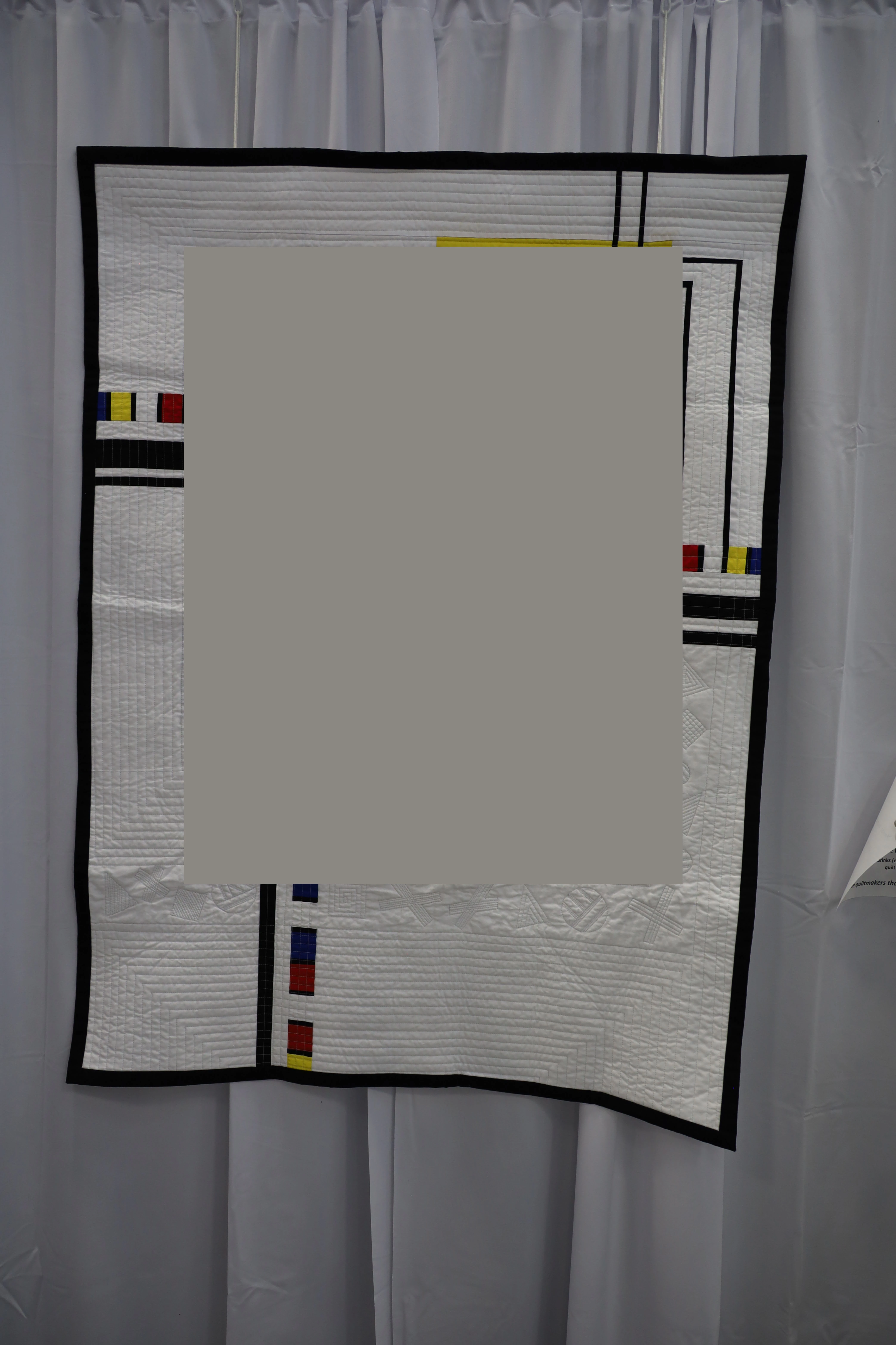

I have to take 100 photos of hanging quilts and straighten the side & square the corners. What is the best method to do that. Sample attached--design covered to protect maker.

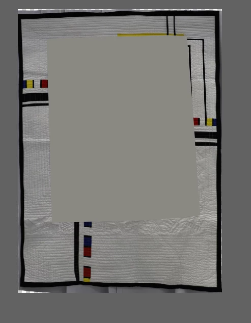

There are a couple of tools you can use.  In this quick example, I have first used the Perspective Crop tool (which is found with the Crop tool).  Then I used the Warp tool which you can access via the Image>Transform menu.  Finally, I straightened out the edge of the material using the Pucker tool in the Filter>Distort>Liquify dialog.
If you have the time to spend, you can get better results than my crude effort here.
