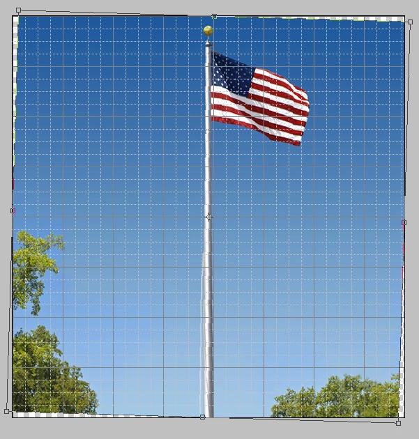

August 11, 2017
Using the Free Transform tool suggested by hatstead, it will help if you view the Grid. Then you can align the object along a vertical grid line:
