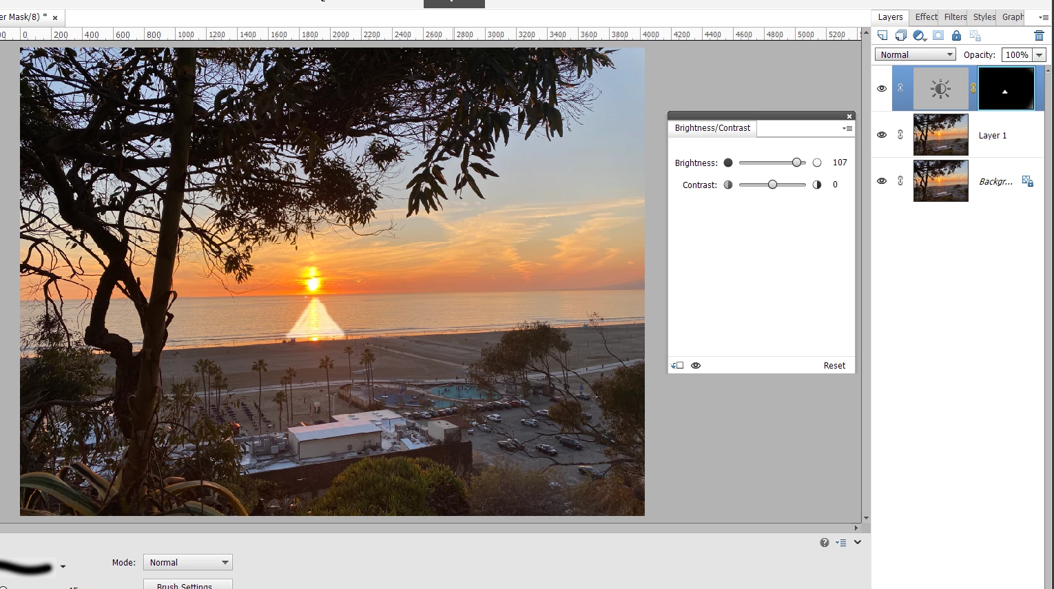

I'm not sure if I fully understand you with respect to how you are drawing the cone.  But, you can create a Brightness/Contrast adjustment layer and use a brush to paint the light cone on the mask.  You can use shift-click to draw a straight line on the mask.  Here is a crude example.  (The lines are not completely straight because I quickly filled in the cone between the lines.)

Thanks Greg. Yes, that is an acceptable work-around. I was hoping though, that there was some way to use the same method that works in Lightroom*. Evidently that may not be possible in PS Elements.
