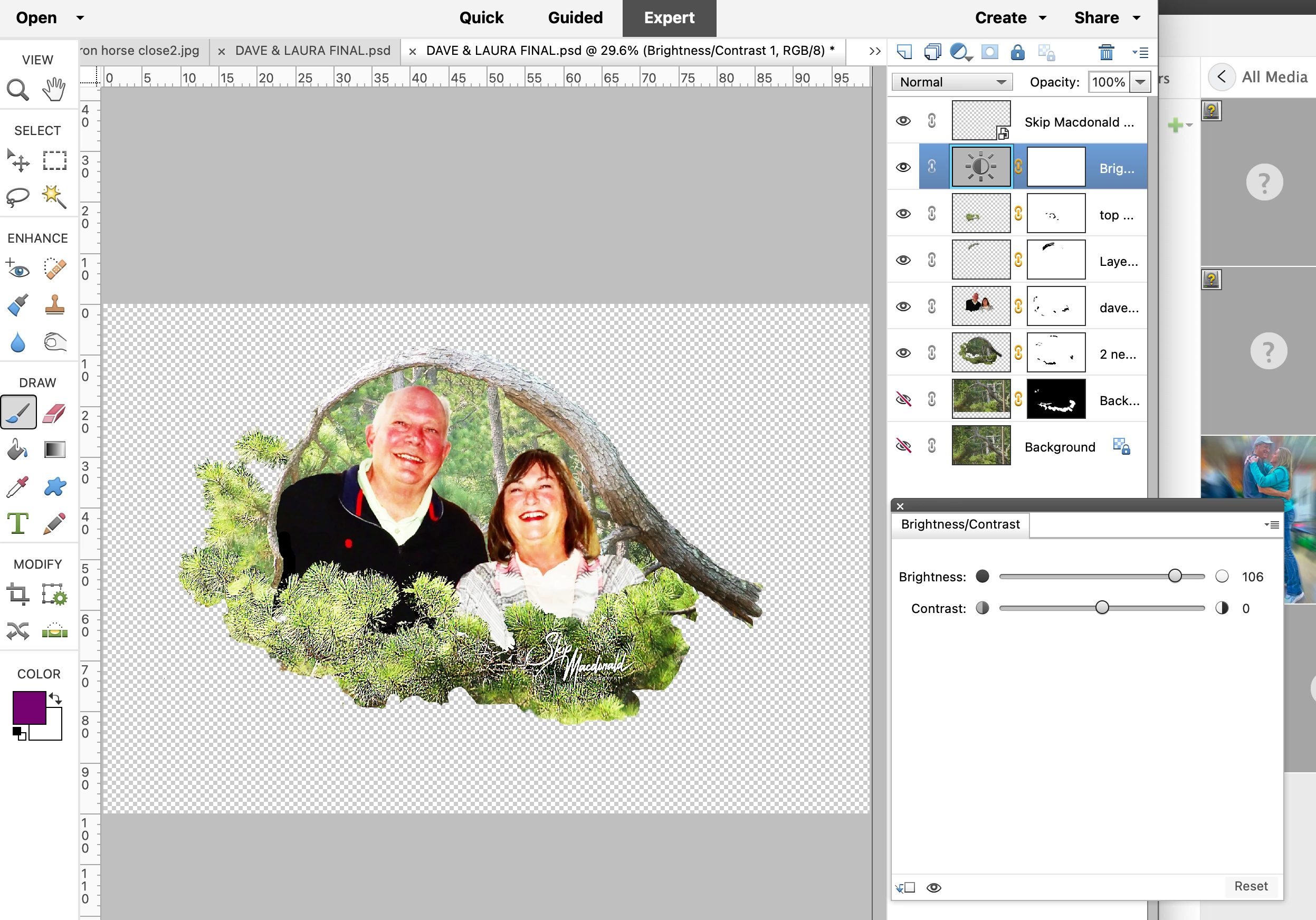

skipmacdonald
Feb 24, 2023 7:29 PM UTC
yes, but it didn't work.  Still affecfts all layers

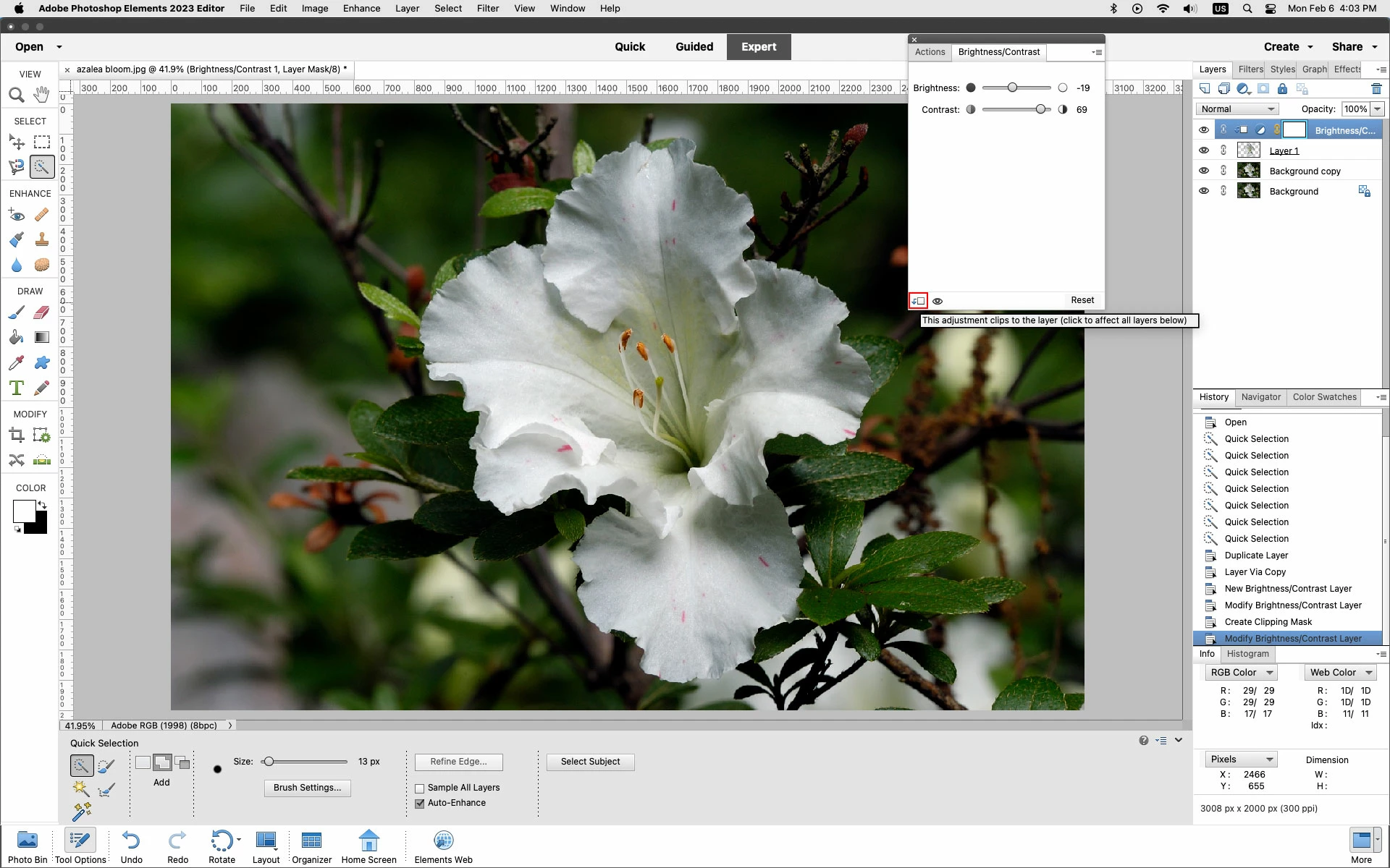

Jeff Arola
Feb 6, 2023 9:06 PM UTC
If you want any adjustment layer to affect only the layer directly below you can make a Clipping Mask by having the Adjustment Layer active and going to Layer>Create Clipping Mask or click the Create Clipping Mask button at the bottom left of the Adjustment Layers panel.
skipmacdonald
Feb 23, 2023 12:57 PM UTC
tried that but didn't work.  btw I am using elements 2022

skipmacdonald
Feb 6, 2023 6:25 PM UTC
using brightness/contrast

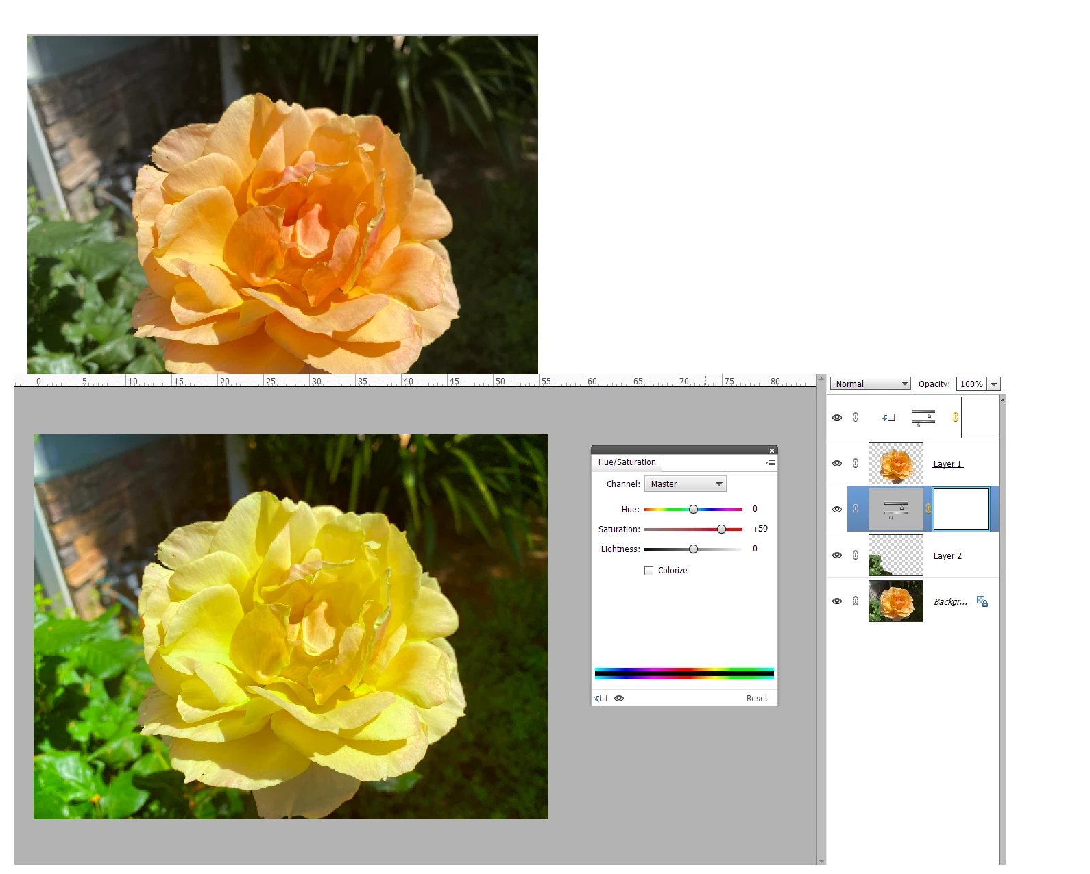

Greg_S.
Aug 16, 2022 7:57 PM UTC
You need to make a selection of the area you want to change and then create the adjustment layer.  In the following screenshots, I have created two new layers from a selection on the original layer (the flower and the green leaves on the left).  I then applied a hue adjustment layer to each.  Let us know if you still have questions.  If you do, please give us a screenshot of the image and your layers panel.
