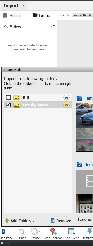

I have the exact same problem. I am point to a network share, not a mapped drive.
Organizer completes the process, asks about tags, show a report of files it will not import, but then shows nothing.
It just goes back to the main page like you never did anything.
It shows 0 Item on the bottom left and no folders are displayed.
In the "Import Media" window of the Bulk Import process, it indeed does show the folder on my NAS.
And it shows all subfolders and displays thumbnails of the pictures.
Is there a log file somewhere so I can troubleshoot this?
Thank you for any advice.

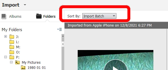

Yes, it will take a long time to import 40,000 files via a NAS.  And if you view the grid using the Sort by Import Batch, does that give you any clues as to what may have happened?

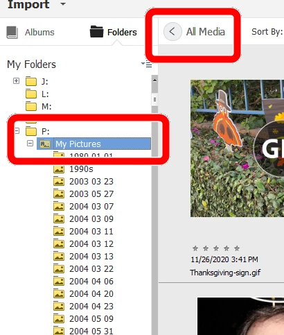

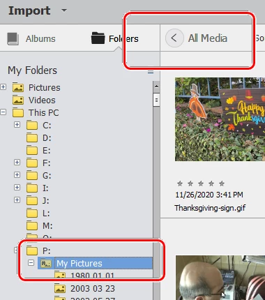

How are you trying to view the photos in your catalog?  If you are using the Folder panel on the left side of the screen, it will only show the photos in the particular folder that you have selected.  So, if you select a My Pictures folder as your "main folder",  it will not show any images contained in any sub-folders.  You would have to select each sub-folder to see its contents.  If you click on the All Media arrow-button at the top left of the grid, do you see all of the photos that you expect to see in the catalog?

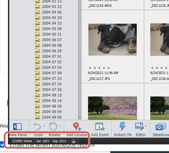

How many files are in your catalog?  Without selecting any of the images on display, the number will be shown in the lower left of the status bar.  Is this consistent with how many photos you expect to have in your catalog?

What happens if you click on the All Media button?  Are you then able to see any photos?

You say that you have all of your photos in one folder?  Is that the My Pictures folder and do you have any sub-folders?  I suspect you have multiple folders and are using the Folders panel on the left to select your view.  If this is the case, selecting the My Pictures folder will only display images stored in that particular folder, not all of the images in the sub-folders.  If my theory is correct, click on the All Media button at the top of the window and all of the photos in your catalog will be displayed.

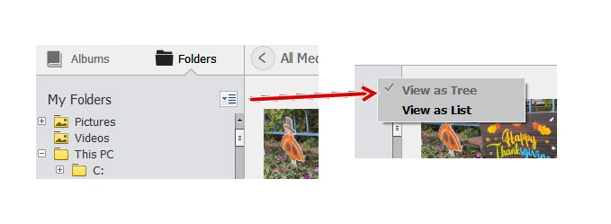

If you wish to view your photos by folder, also make sure that you are in the Tree View, not the List View.  Click on the hamburger button next to the My Folders heading and make sure that View as Tree is checked.  This will replicate the Windows Explorer tree.

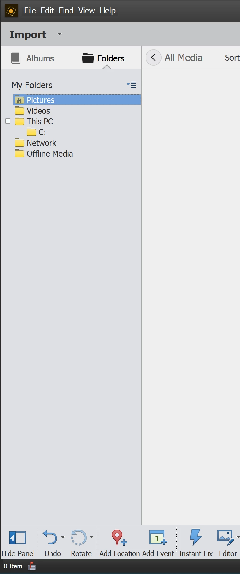

Once again Greg thanks for the suggestions.  So I found a de-duplicator and pruned the number of files just to speed things up.  After that I was able to see that the import of now 14K files (yes I had way too many dups) stops at the same number every single time i.e. 9704, it says 9704 imported but none of them display.  The screen shot below is after the import
