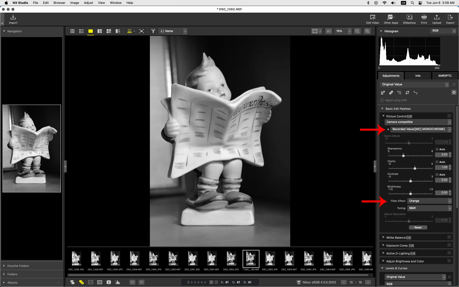

Jun 6, 2023 7:33 AM UTC
In Nikon Studio NX you can see what settings were used for Picture Control as in the example below
MONOCHROME with an Orange filter was used.
Then in Adobe Camera Raw under Profiles go to Camera Matching and pick the relevant one such as O for Orange.

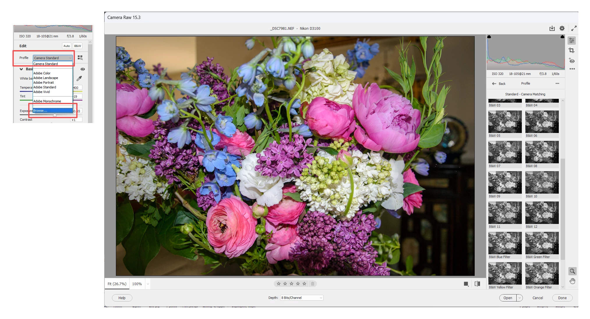

Jun 6, 2023 2:11 AM UTC
I have updated my ACR in Elements 2023 to 15.3 (using a workaround), but I believe you should see the same with the released version of ACR 14.x.  In the right-hand panel, you will see a dropdown menu for profiles.  If you click on the Browse option at the bottom of the list, a number of collapsed option profiles will appear including some for Black and White which is shown in my screenshot:
Does this give you what you want?
MichelBParis
Jun 6, 2023 7:13 AM UTC
Greg is right that there is no difference in the Camera Raw dialog on Windows 10 and ACR 14.4.
That's the simplest way to be guided to many variations of conversions to black and white.
From the online help called from the ACR dialog help icon:
https://helpx.adobe.com/photoshop-elements/using/processing-camera-raw-image-files.html#main-pars_heading_1
Keep in mind that:
1 - your camera provides "raw" data (photo sites light intensity, not colours) filtered through an array of colour filters. That raw data has potential ability to recreate colours after conversion according to your choices. Unless you are using custom-made camera sensors, you always shoot raw for colour output. There is no Black/White raw NEF file, there is a common raw file which can be processed in either way.
2 - You can always "remove" colour from a file in any photo (not raw) format. That's the process which is being used to get black and white output from a raw file. The raw data is first processed into a virtual colour image, which is converted to black and white. The Nikon software uses your choice of style and directly shows a converted version, the ACR version needs you to tell which possible style you want (as shown by Greg).
Note that you can convert any image to black and white in the main editing dialog by pushing back the saturation slider to zero to the left.
