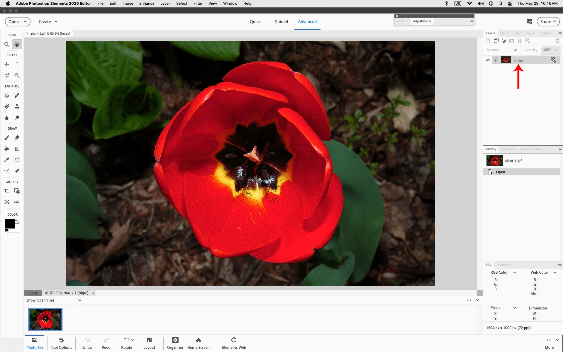

Jeff Arola
May 29, 2025 2:49 PM UTC
You mention Gif in your first post so most likely your image is in Index color mode, which would cause the Type Tool to create a red mask.
In the Layers panel does it say Index to the right of the image thumbnail?
jhaber3
jhaber3Author
May 29, 2025 5:00 PM UTC
Have to admit I find that puzzling, as I'd been updating the text on what I presumed was the top layer weekly for years now. But it indeed is a gif. And I found my way to open the right panel, and it does say "index" just to the right of a thumbnail of the image.

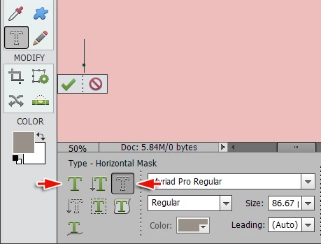

Greg_S.
May 27, 2025 2:07 PM UTC
@jhaber3 if you are replying by email we cannot see your screenshot. You have to use the forum to upload a screenshot. But based on your description, you have clearly chosen the Horizontal Mask type tool.  In the Tool Option panel at the bottom,  click on the first tool which is the Type-Horizontal tool.  It is the one that Andrei has marked with the arrow on the left of his screenshot.

May 27, 2025 3:59 AM UTC
Just another suggestion:
Aren't you trying to use the "Type Mask" (instead of the regular "Type" ) tool?

jhaber3
jhaber3Author
May 27, 2025 12:33 PM UTC
Thanks to all. Here's a picture (not quite all the way to the right edge), and I don't think it's a type mask tool, although it does seem to my uninformed self to act like one. As you'll see, the left frame, in which you pick a tool, does when I mouse over it, say "Horizontal Type Tool (T)," and the bottom frame, for modifying the tool, does as well, with the 1st of 7 icons. (The third and fourth items are labeled "Type - Horizontal Mask" and "Type - Vertical Mask." I have not tried to use them and don't know what they'd do.) And you'll see in the  main frame what happens when I click on my image, expecting the tool to select type. Things turn red, and I was guessing that was the act of a Mask. I'm stuck.

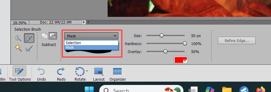

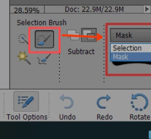

Greg_S.
May 26, 2025 7:27 PM UTC
If you open the Selection Brush tool, is it in Mask or Selection Mode?
It probably doesn't matter since you say the problem is occuring with different (unspecified) tools.  My only suggestion without more details or a screenshot, is to try resetting the preferences file. Go to the Edit>Preferences>General tab and click the Reset Preferences on next launch button.
