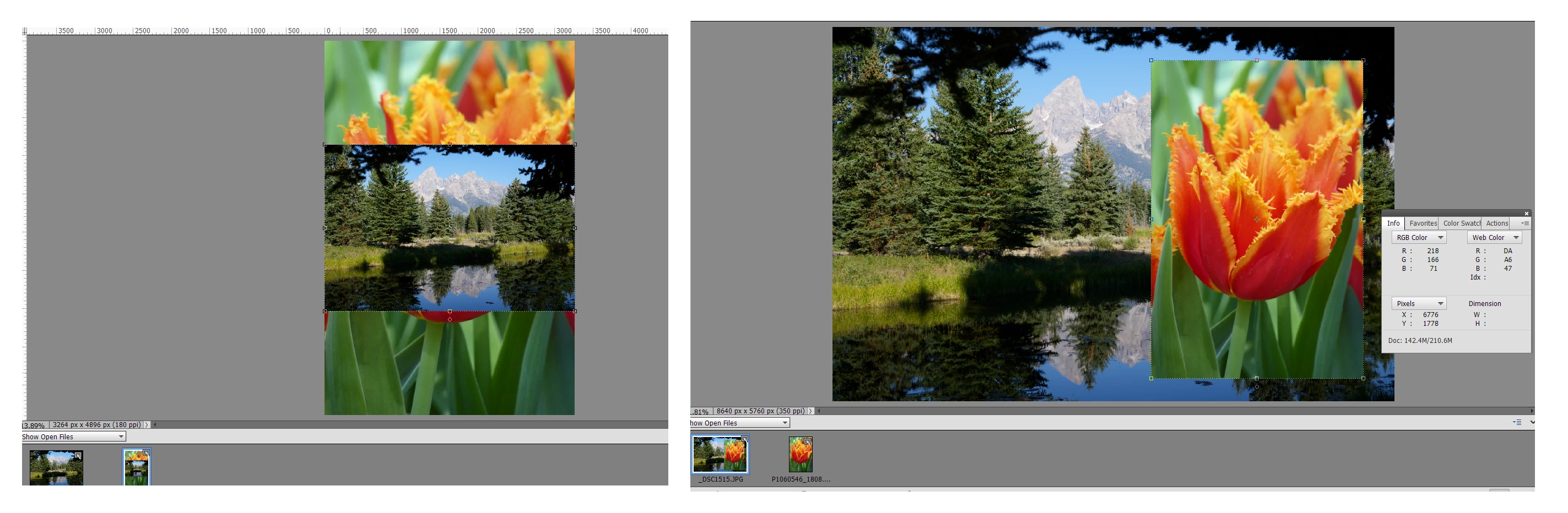

August 16, 2021
I agree with Walter.  It depends on the resolution of the files.  In the following screenshots, the portrait oriented flower is a lower resolution file than the landscape image.  Dragging the flower onto the landscape, it retains its lower size and fits within the image. When dragging the larger resolution file to the flower, the size is reduced to fit within the frame of the base image.  I think the program assumes that you want to end up with an image the size of the base.  So any layers you add to the base will fit within it.  Since all layers that you drag up from the photo bin will be smart objects, you can resize them as many times as you want without losing any image quality.
