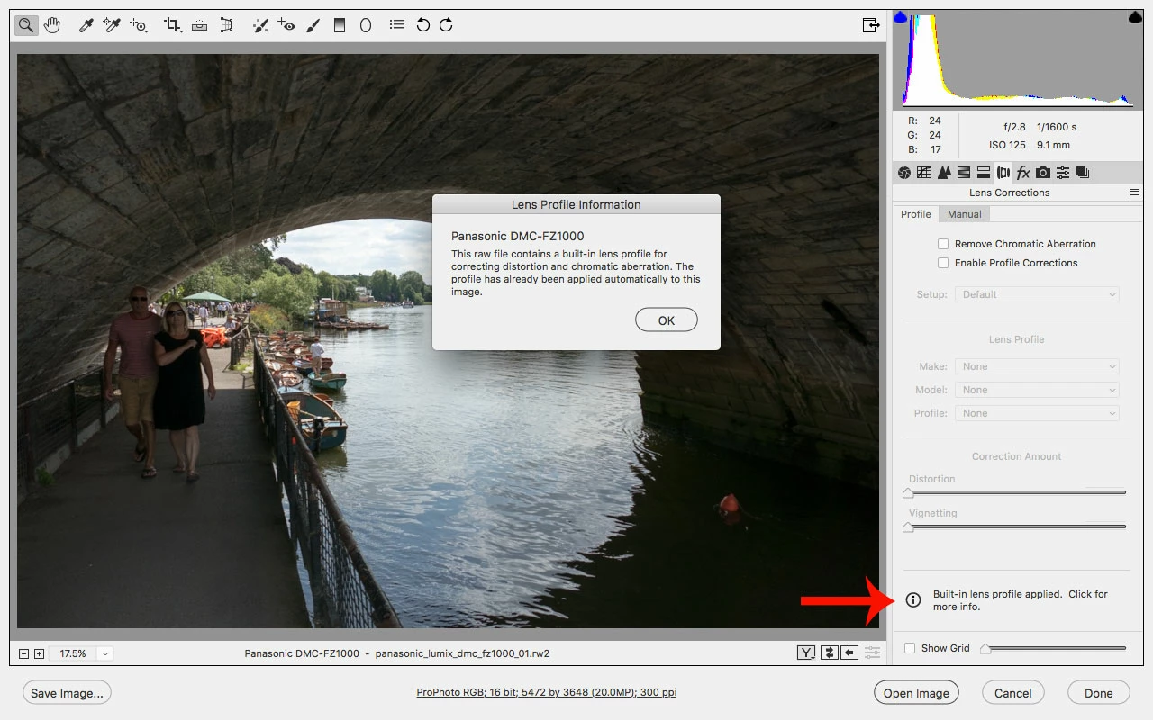

    I believe the Panasonic FZ1000 uses built in lens corrections.
    in other words the lens corrections are done in camera and recent versions of adobe camera raw can read and apply the lens corrections automatically.
    Anyway, when i opened a sample image from below in photoshop cc its says that lens correction is already applied and when opening the same image in photoshop elements, it looks as though it reads the lens corrections as well.
    That's not to say that some images taken at the wide angle settings of your lens might not need some additional corrections using Filter>Correct Camera Distortion.

    Thanks very much. I am not sure if the camera adjustment deals with perspective distortion, only barrel and pincushion, so will have to investigate that. Also, it appears that the toolbar they show is from PS or CC so my concern about PSE not being powful enough is becoming a real concern. Any other ideas you have will be much appreciated.

    The lens correction filter not only deals with barrel and pincushion distortion, it also deals with perspective. Even before that useful filter was introduced, I have been able to correct perspective from the other tools in the distortion options of the enhance menu. I can do what I want in this domain, but it's true that the  new tools in Photoshop or Lightroom are easier and more powerful. Several years ago, I also used DxO which was the leading software for perspective correction, but I no longer use it since I can do what I want in Elements. My advice: download the trial version of PSE15, play with it and ask if necessary.

    Thanks for this and yes it does. However, I believe this deals with barrel and pin cushion distortion, not perspective distortion which is ideally what i will need. Another user has replied pointing me to the camera for this and I will need to nvestigate that now. Thanks very much anyway.
