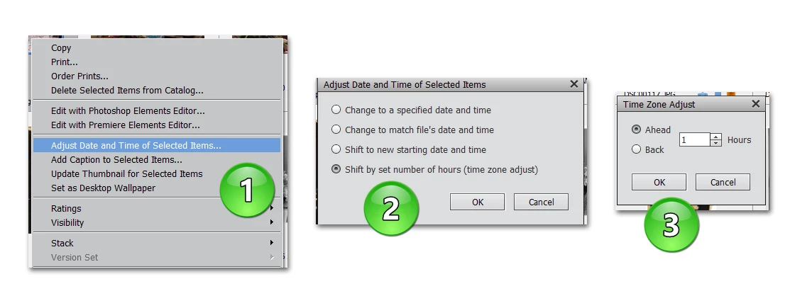

There may be a simple explanation (and solution) for your problem.  I assume that you are shooting in jpeg/raw formats, and that all of the jpegs shot on a day are displayed separately from the same images shot in raw format on the same day.  If so, take a look at the displayed date and time for each photo shot as a jpeg/raw.  They are almost certainly different and the difference will be by a constant number of hours.
I have seen this reported before when a user has changed the time zone on a camera when going to a distant location.  When the user has returned home and imported the images to his computer, the jpegs and raws are displayed according to a different time.  This would seem to be a bug in the camera's software.  IIRC, the camera was a Sony.  (I suppose the problem could also occur if Daylight Savings adjustments are set on the camera.)  I think I have also seen this myself on my Sony camera but at the time I didn't investigate the cause.
If I have correctly diagnosed the problem, the solution is easy.  Simply select all the photos with the "wrong" dates/times, and use the context menu to
  1. Adjust Time and Date of Selected Items,
  2. Choose Shift by set number of hours (time zone adjust)
  3. Make the appropriate change
If this is not the case, then please do as Michel asks and give us some more information.  Also, what OS and version of Elements are you using?
