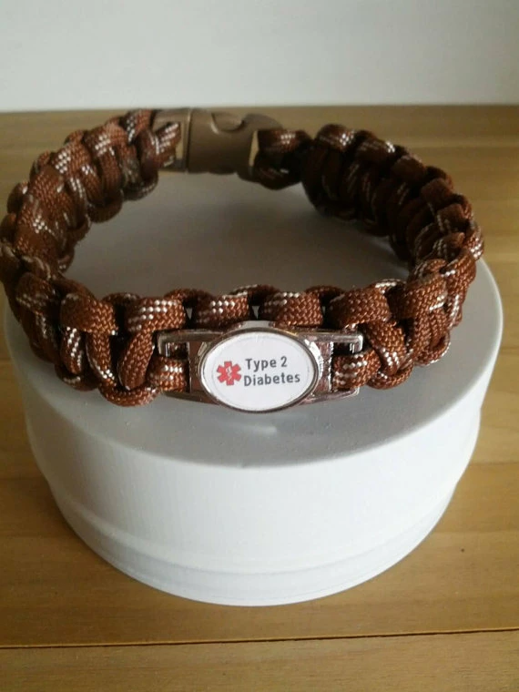

    I do want an accurate charm for sure.
    I actually mailed one of the charms to a person and they made the purple one.
    I am not sure how accurate the red white swirl one is because it is just an example picture of what the charm can look like when an insert is inserted. Then there is clear acrylic that goes over the picture.
    I didn't even know how to do that. She created it in a program called SCAL5.
    Here is another example
    I hope I can figure this out cause I have these which I hope will be easier. They are oval that I want to do too.

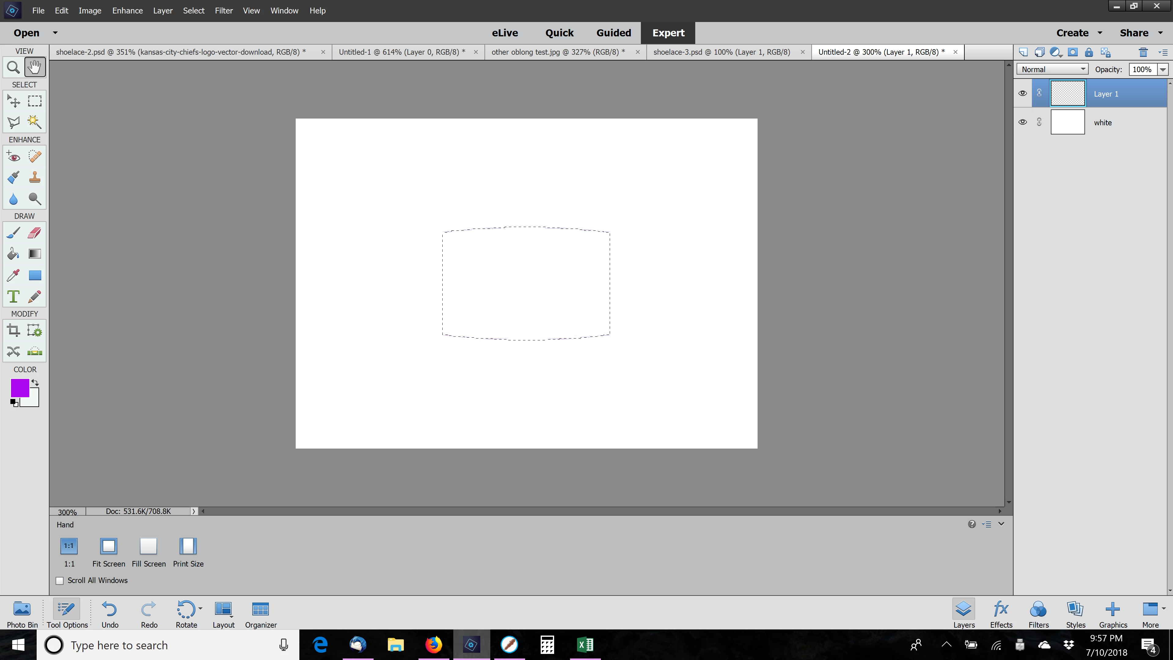

    Ok that kind of works, but when I delete it, it turns the background white. A screen shot here.

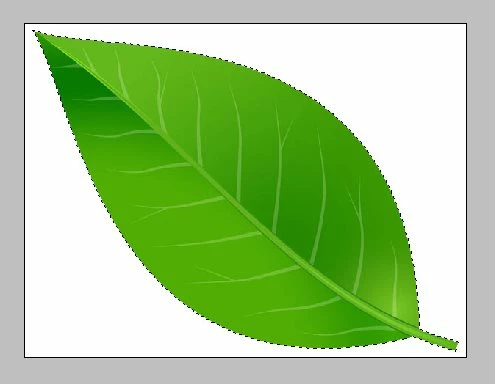

    Here I have a jpg leaf on white background. Select the shape using the various selection tools. In this case I used the Magic Wand (with the Contiguous option) to select the white background, then inverted the selection so that the leaf is now selected:
    Copy the selection to the clipboard (Edit > Copy, or Ctrl-C)

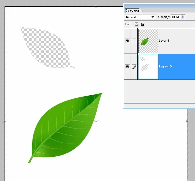

    This places the shape on a new layer:

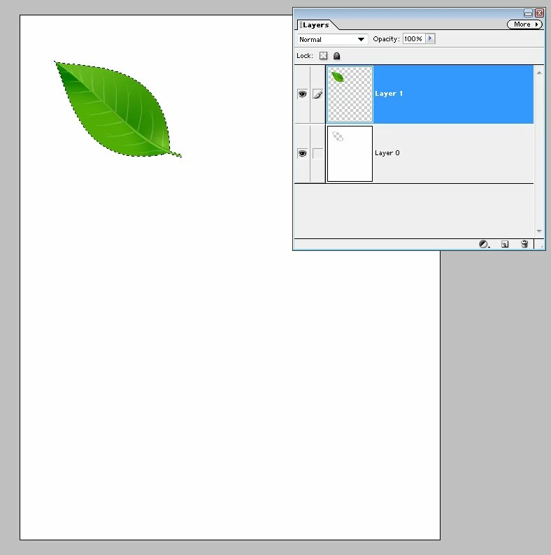

    Ctrl-click the layer to select the shape.

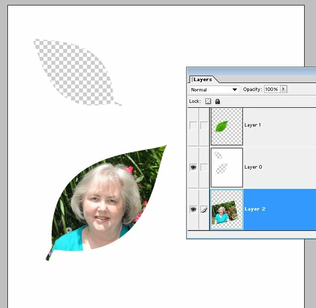

    Activate the template layer and <Delete>. This creates the transparent shape in the template.
    To create additional transparent shapes, activate the shape layer and use the Move tool to rotate/reposition/resize the shape as needed on the template and <Delete>.
    Note that the reason we rename the Background layer is that when you delete something from the Background layer the deleted item is replaced not by transparency but by the current color in the background color chip in the toolbar
    When you are finished delete the shape layer or turn off its visibility.
    To place a picture within one of the transparent shapes, add it below the template layer. Rotate/reposition/resize the picture layer as needed to place in the shape:
