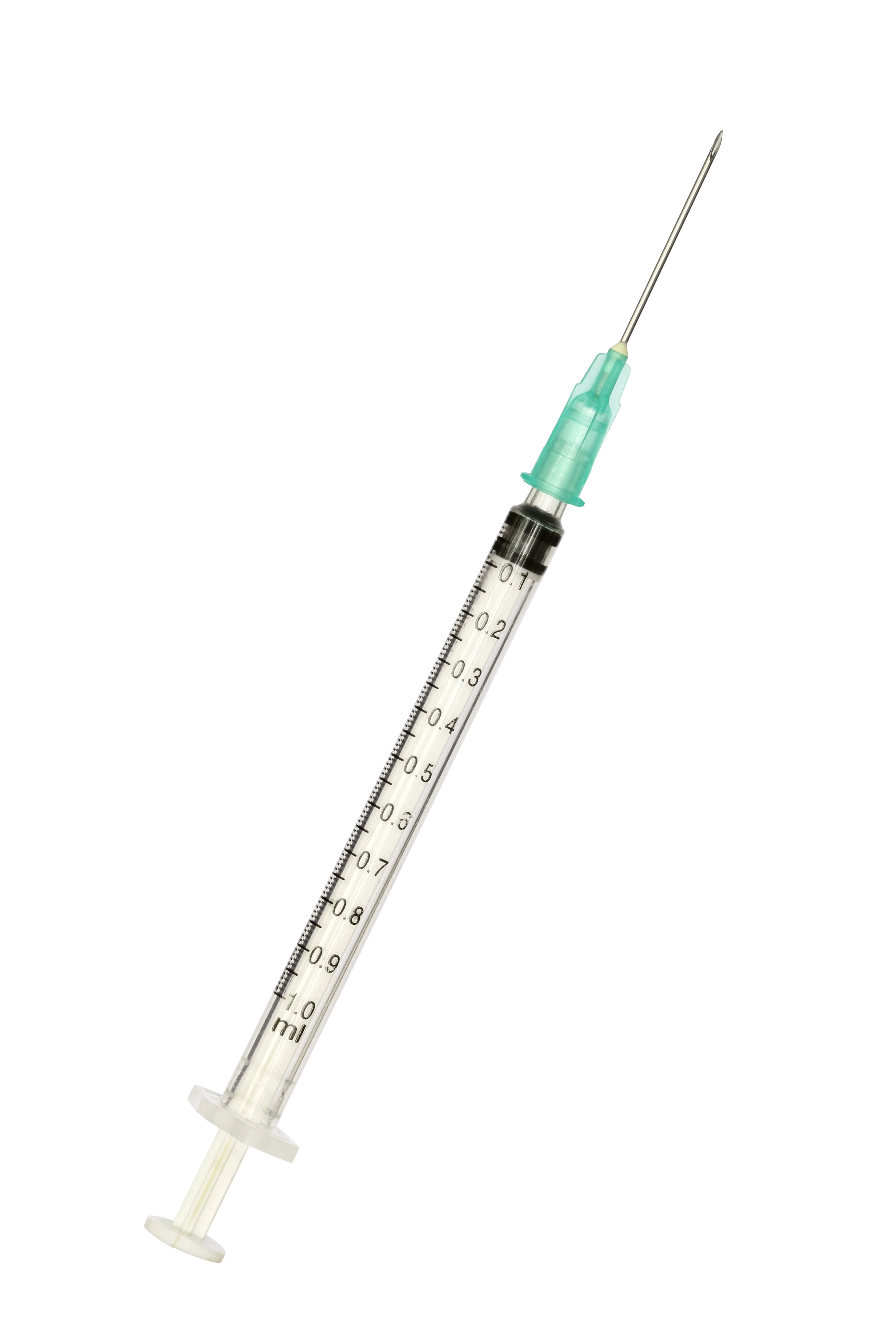

I am trying to remove the white background from a photo of a needle so I can use the needle as a graphic on a t-shirt. I have tried to use a few of the solutions here, but I can't find the items they suggest, such as the "magic wand", and the "Select" menu doesn't work, apparently because the background is not a layer. Also, most suggestions are for previous versions of Photoshop Elements. I am using(or more accurately, attempting to use) Adobe Photoshop Elements 2021. Below is the photo I am trying to use(I apologize for the size).

I forgot to mention that before you do anything else, you need to double-click the background layer in the Layers panel.  That will turn the layer into a regular layer.  When you delete the white pixels, the background will then be transparent.

Just to add to @Greg_S. 's excellent walkthrough - the Guided > Replace Background feature does a pretty good job too on this particular image just using the one-click Select Subject button. It needs a little tidying up with the Refine Edge Brush, but nothing too difficult - it's helpful to actually choose a Color background for doing this tidying up work (rather than None) - but you'll then need to quickly go into Expert mode to delete the color background layer right at the end.
Greg_S.
March 12, 2021
Here is one way to do it.  Follow along with my screenshot:
  1. Choose the Quick Selection tool from the tool bar.  (The active tool may be different in your toolbar, depending on which selection tool was last selected.)  Or you can use the keyboard shortcut A to cycle through these tools or to open the tools in the tool bin.
  2. In the tool bin, select the Magic Wand tool.
  3. Make sure the tolerance is fairly low (because you are basically looking for a pure white color).
  4. For this project, you should check the contiguous box because you only need to select the white pixels surrounding the syringe and to isolate it.
  5. Click anywhere on the background white.
  6. (Optional) click on the Refine Edge button and a new dialog will open.
  7. Choose one of the different Views from the dropdown menu.  In my screenshot, I have chosen overlay which nicely displays what has been selected.
  8. If you are satisfied that the syringe has been isolated from the selected white background, click OK.
  9. Press the delete key.
  10. Save the file in a format that preserves transparency such as .png.
