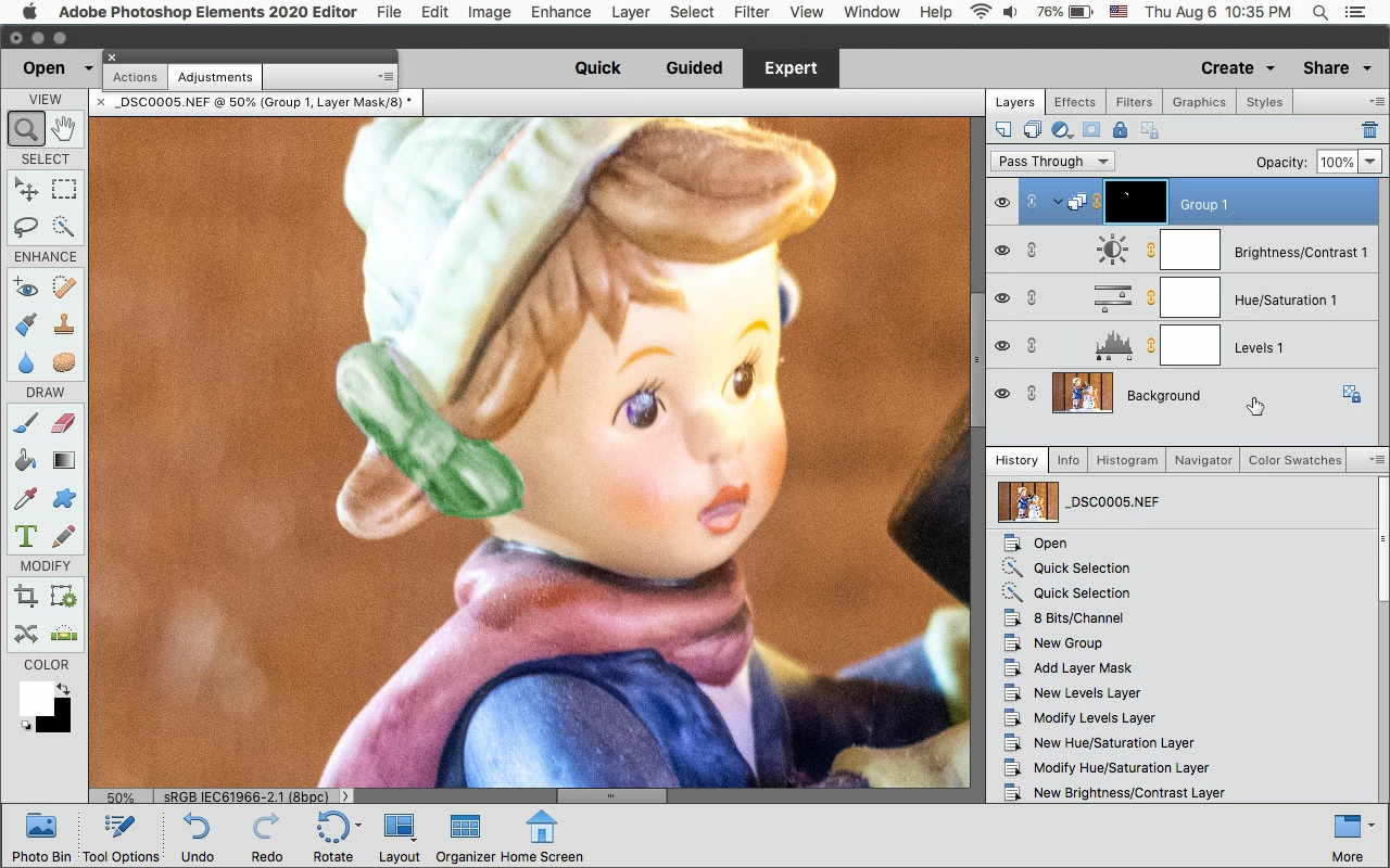

You could add a New Layer Group (Layer>Group Layers), add a Layer Mask of you selection to the Group, then put your adjustment layers inside the group without the need add a selection mask to each adjustment layer.
The green bow on the hat is the target of the adjustment layers in this example.
