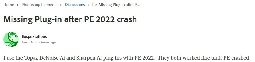

My apologies for posting originally on the Photoshop Premium form - I thought I had selected the correct one as my original post showed I posted to the Photoshop Element forum at the top of the post (see attached).
