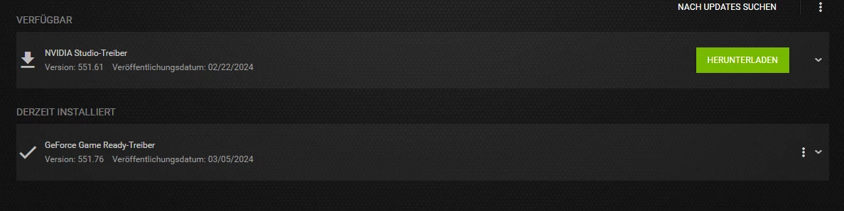

Peru Bob
Mar 17, 2024 5:15 PM UTC
Make sure to use a Studio Driver from NVIDIA (NOT the Game Driver), but not the latest version - it has issues with Premiere Pro and may have issues with other Adobe programs.
Mar 17, 2024 5:29 PM UTC
i do this update now, you think that was the Problem ?
i have this problem for a long time like 1 year.
Thank you
