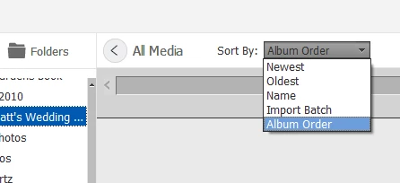

Yes, we need some more information from you. So the basic question we need you to answer is whether you are viewing a folder or an album? And here is why:

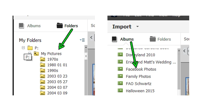

The Elements Organizer is a database of the photo and video files stored on your computer in folders on a hard drive.  Once you have imported your photos into the Organizer database, they can be sorted for viewing in 5 basic ways:
You can limit your view of the visible images to just those that are stored in a single folder by clicking on a named folder in the Organizer's Folder panel at the left of the Window.  Only one folder can be viewed at a time.
Alternatively, you can limit the view to an Album that you have created.  Albums are database collections of files that may be stored in many different folders on your computer.

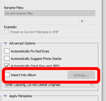

Albums can be created automatically when you import files from a camera using the Adobe Photo Downloader.  Is this what you have done?
Photos in a folder or album are arranged according to the Sort By dropdown menu shown in my first screenshot above.  The choice of Album Order is only available if you select an Album for viewing.  You can manually change the order of photos in an Album, using the Album Order.  Simply click and drag the thumbnail to a different position in the grid.
However, you cannot change the sort order of files in a folder which is govenred by the Operating System's date and file name information. If you are saying that the files from each camera have been placed in different folders, it is possible to move them from one folder to another by click-and-drag, using the Folder panel.  And here is where we give a strong warning to manage your files only within the confines of the Organizer and not within Windows File Explorer.
