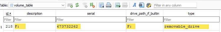

Congratulations on getting it working!  Based on my understanding of what you have done, you have completed the task.  I tried modifying the drive serial number itself when I copied/cloned my media to a new drive, and I ran into all kinds of problems.
As a matter of curiosity, what SQLite editor did you use?

Thanks Greg, I used DB Browser SQ Lite to get the job done.

OK Update:
It looks like I may be stumbling onto fixing this as it now seems to be working!!
I close the organizer and further updated my volume_table in the catalog to the following:
Description: F:
serial: 673732262 (converted to decimanl from the hex value of my drive)
drive_path_if_builtin: F:
type: removable_drive
see here:
and now all photos are in their proper place in the folders in the tree. Viola!
I reset my watch folder to F: and tested it and it works brining in new pictures in the right folders in the tree.
All my people tags are also there (assuming because I copied the entire /PSE Master Catalog folder over from the old fried laptop drive).
Is there anything else I need to consider? Any other tables in the catalog to update?  I want to make sure I get everything.
I hope this process helps someone who wasnt able to restore their catalog from a backup, as this seems to work.
