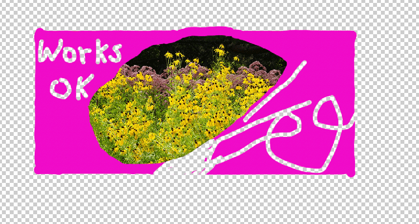

I found a workable solution, so will post. In the attachment without the bee outline, merge the hot pink "mask" with the layer called "Rudbeckia". After that, the eraser tool does the job. There may be more elegant approaches, but this works and seems straightforward enough.

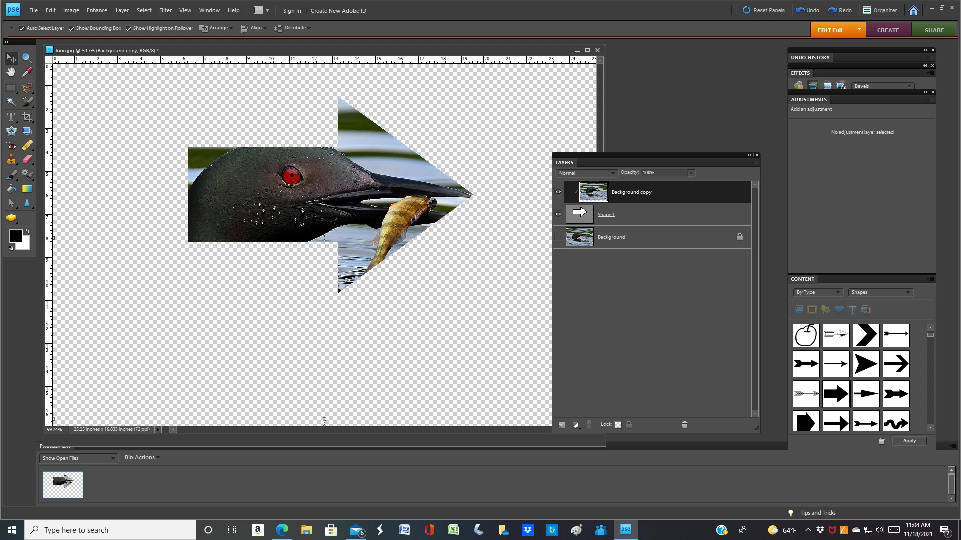

To make cut-outs in various shapes, have a look at the Content palette. You can open it via Window menu. Among various things in the drop-down in the palette, there are all sorts of shapes. For drill, let's use the black right facing arrow.
1. Open your picture file
2. Duplicate the Background layer, and shut off its visibility by clicking on the eye icon.
3.Double click on the black arrow in the content palette, and drag the arrow to embrace what you wish to retain in your picture.
4.In the layers palette drag the shape layer between the the Background and Backgroung copy layers. The background layer should be at the bottom, next up the shape layer, Background copy layer at the top.
With the Background copy layer active, press CTRL+G to create a clipping mask

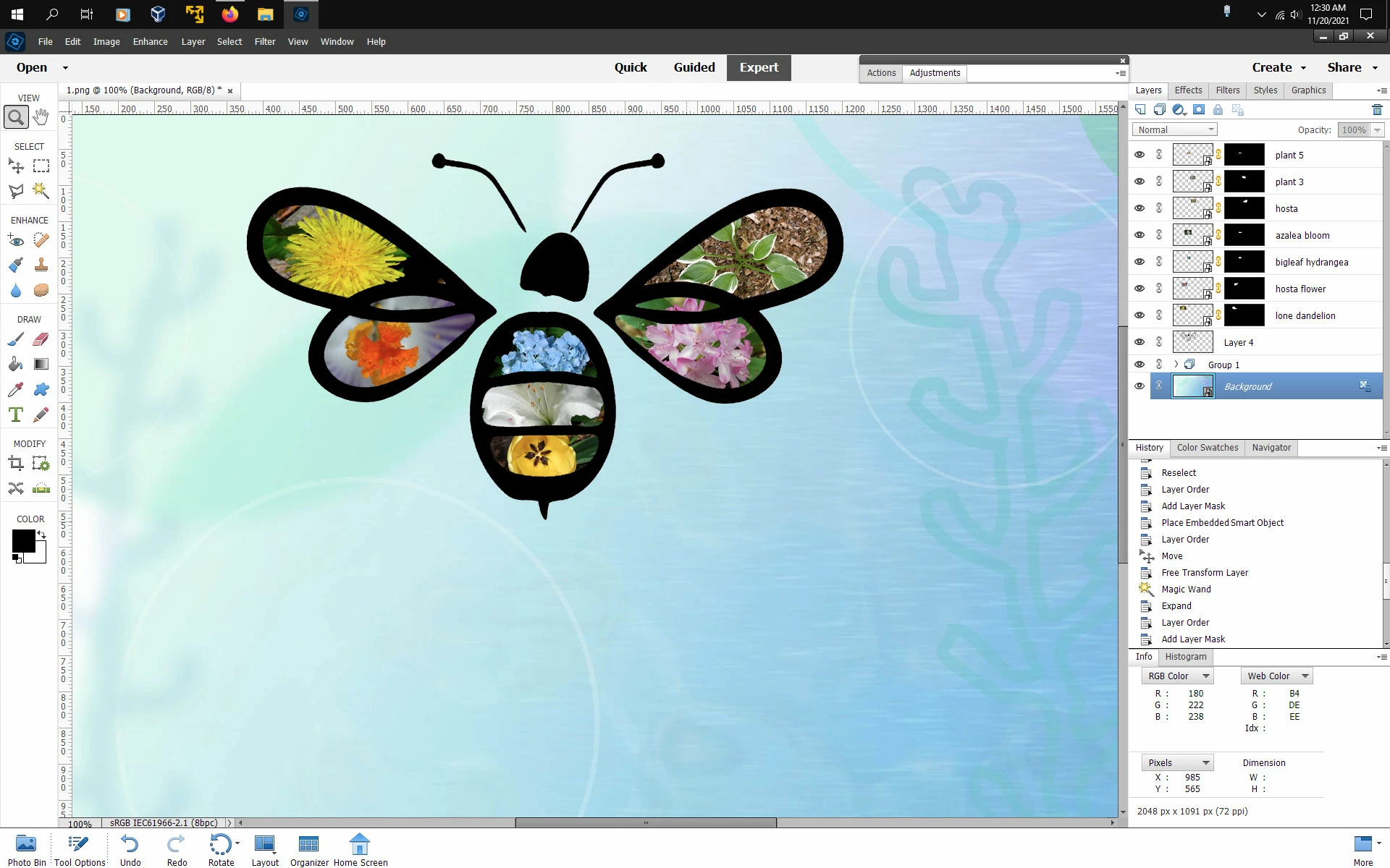

Thanks for the reply. I am attaching two screen shots since I thought it would be helpful to see what I am trying to eventually get at. I don't know what order these will attach. The one with a bee outline is the overall project reference.
If you look at the screenshot with two layers on, one called "LHindwing overlay" and the other "rudbeckia", what I am trying to get is a "removal" of the hot pink area leaving an irregular central area of flowers. The leftover irregular area of flowers will then sit below the bee outline. The final result is intended to be a bee outline with a mosaic of photos filling in different parts of the bee.
