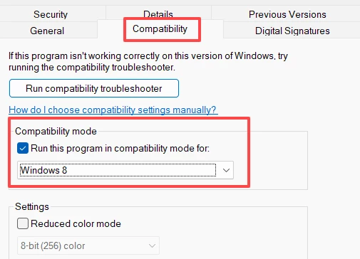

Yes, you can download from the link.  Make sure you download the 64 bit version:
I suggest you install in compatibility mode.  Right-click on the exe file and select Properties.  Choose the Compatibility tab and check the box to run in compatibility mode (for Windows 8).
You may still run into the activation issue and will need to activate offline.  And if you have already installed the program on more than 1 computer, you will need to deactivate from the older computer.
One final note about Elements 13, it may continually prompt you to update the program.  If you select yes, it never updates.  If this is the case, choose the option to remind you later.
