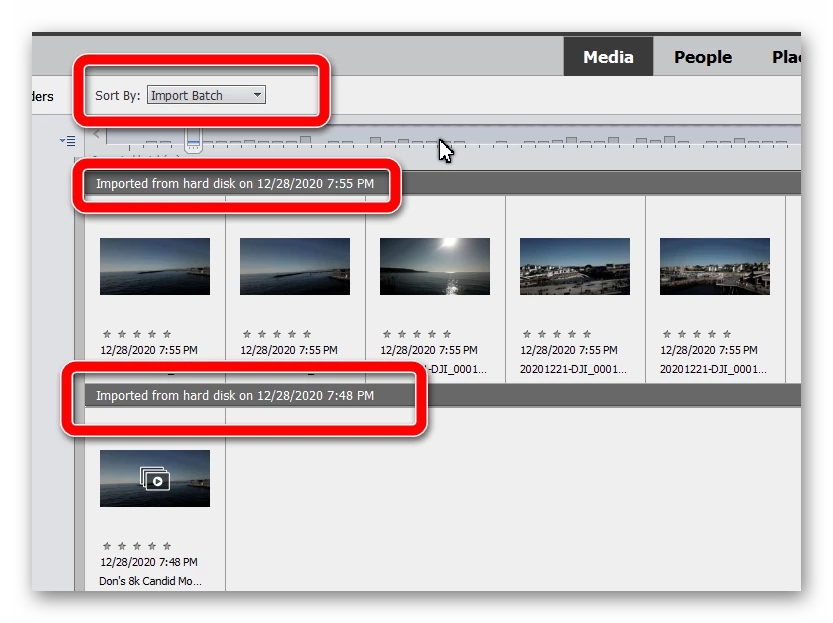

In organizer, *none* of the pictures I batch imported is listed.
Are any photos showing up in the Organizer?  There could be several reasons why you are not seeing your photos in the Organizer, so let's try to figure out what happened.  Since you were importing such a large number of images at one time, it is possible that the bulk import failed.  If you have any images appear in the grid, try using the Sort by: Import Batch.  The images are then sorted in the order in which they were imported and will show the date of the import.

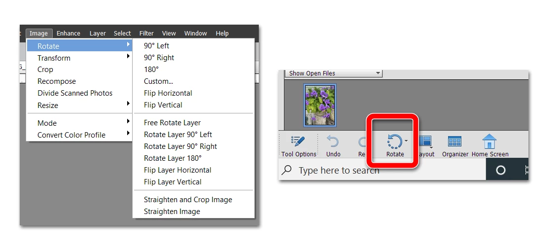

In editor, it took me quite a while to find out how to rotate an image (nothing so simple as a right click menu, sadly),
Yes, it's true there is no right-click option.  But there is a one-click button to rotate.  (And a regular menu option.)

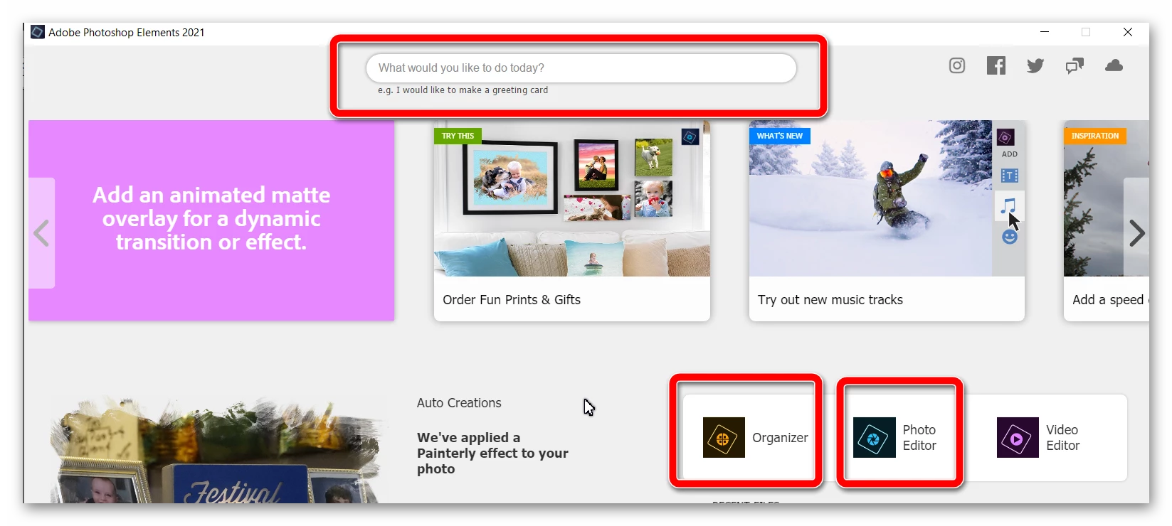

Photoshop Elements consists of two applications - the Organizer and the Editor.  The Organizer catalogs and presents the photos stored on your computer for viewing in one place.  The Editor is used to edit your photos.  When you click the Elements icon on your desktop, it will open the Welcome Screen which has icons/buttons to open each of the programs.  The Welcome Screen is also useful for finding help; there is a text box at the top where you can type in things such as crop a photo.
It is not clear from your post whether you are in the Organizer or the Editor (or the Welcome Screen).

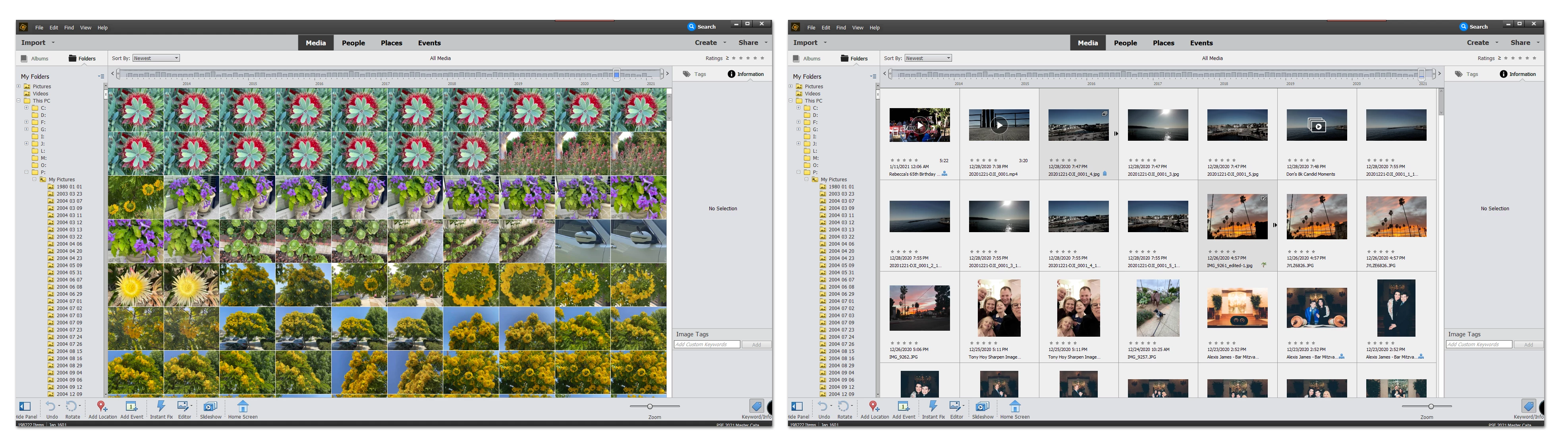

In the Organizer, you should have a grid showing all the photos you have imported.  It should look like one of the following:
I prefer to work in the Details view (which is on the right).  You can toggle between the two views by pressing Ctrl+D.

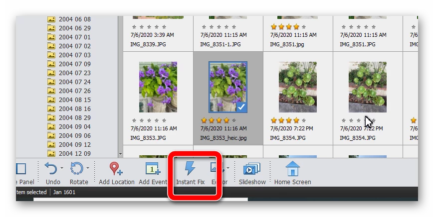

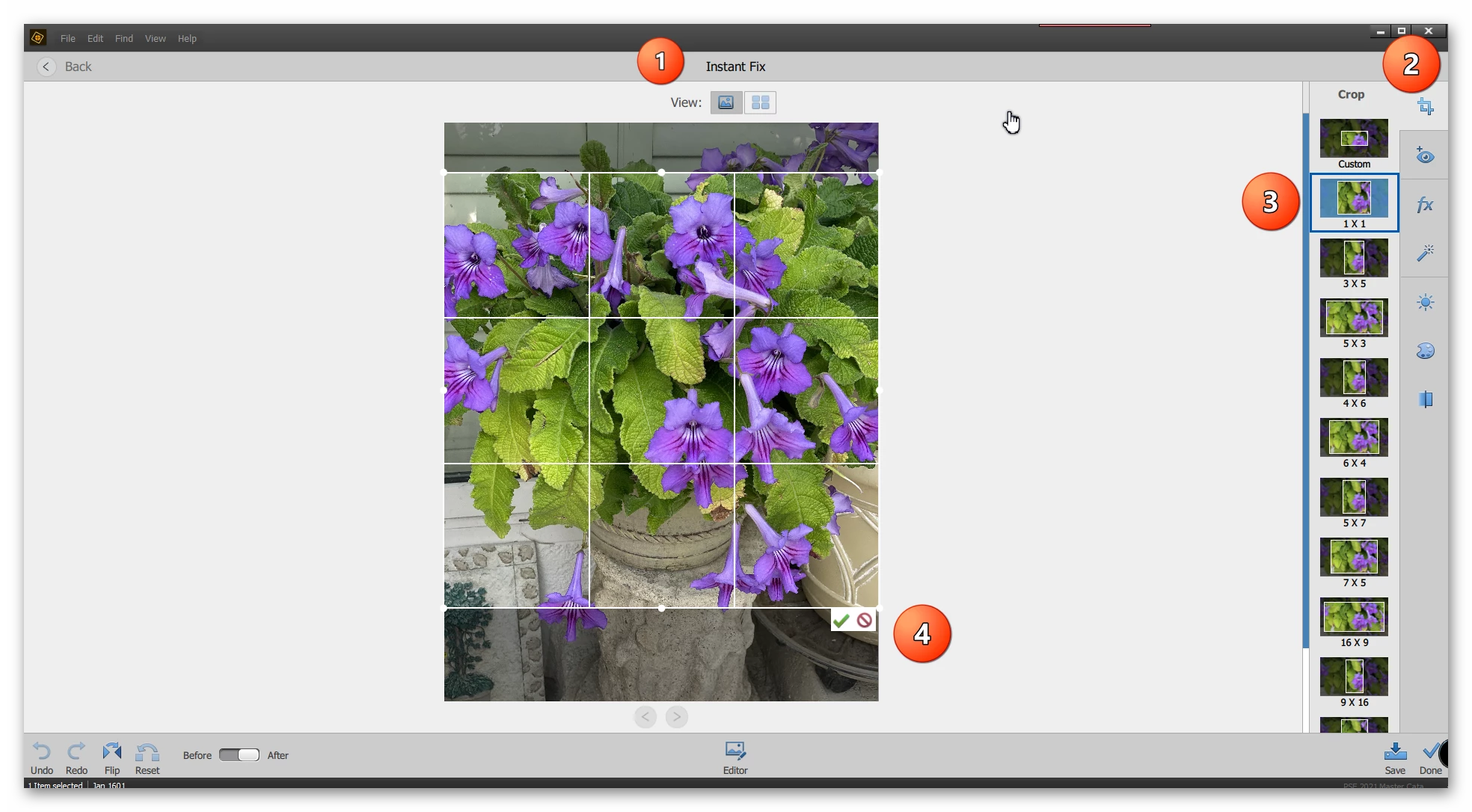

There are some limited editing options that are available in the Organizer.  You get to these by selecting a photo or photos in the grid and clicking on the Instant Fix button in the toolbar at the bottom of the screen.
This will open a new dialog window where you can make several adjustments to your photo, including cropping it.
Alternatively, if you want more editing options and control, you need to open the file in the Editor.  There are several ways to do this.  I prefer to select an image or images in the Organizer and use the shortcut (Ctrl+I) to open the files in the Editor.

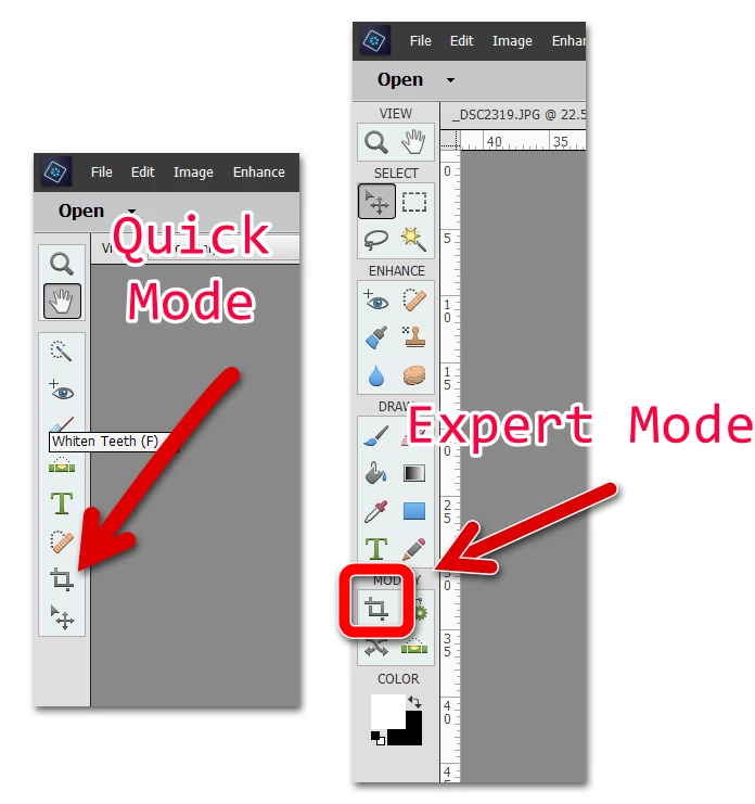

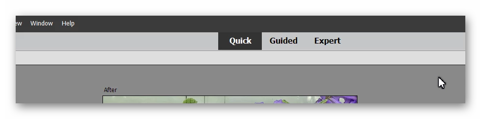

If you are already in the Editor, there are 3 different modes to use:  Quick, Guided and Expert.
The default usually opens in Quick Mode which has a limited number of tools, but does include the Crop tool.  Obviously, the Expert mode also has the crop tool.

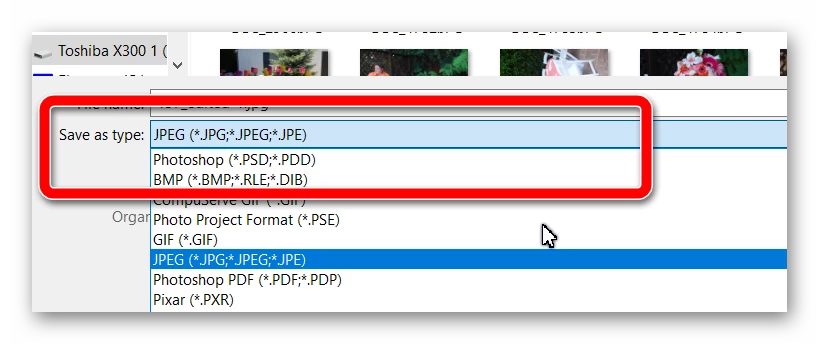

Your files can be stored wherever you want them to be stored on your hard drive.  When you want to save a file, use the File>Save As dialog.  If you have already set the preference option to save to Cloud, there should be a button available to store on your computer.
Files saved to the Adobe Cloud are saved with a .psdc extension.  However, there is a dropdown menu in the Save As dialog which allows you to switch to jpeg or many other formats:
