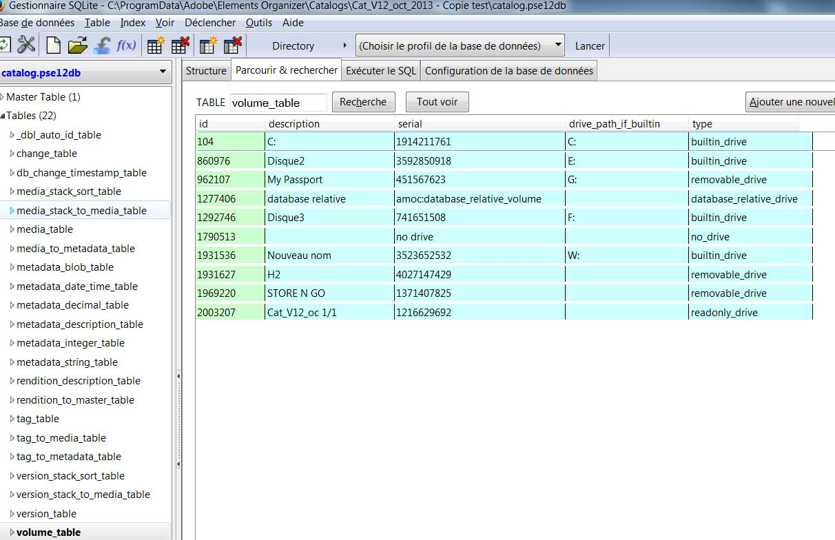

The organizer stores the files location in its database in two segments:
- the full path (the folder tree structure)
- the drive identification, which is NOT ONLY the drive letter. The 'volume_table' stores  the drive letter, but also the internal serial number of the drive assigned in Windows and the volume name.
If you 'clone' your old drive, this normally assigns the same drive serial number, which will create confusion in the database if you are using both drives at the same time.
You can check the serial number of a drive from the command line 'Vol X:' where X is the drive letter. You get the serial in hexadecimal number.
More details in the help doc of John R Ellis.

I am not sure if removing the old drive or if assigning a new serial number as suggested in that doc would solve your problem. Generally, it is recommended to use the normal process of a full backup then a restore rather than cloning.
