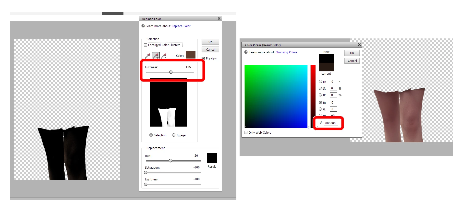

There are probably better ways to do this, but here is one way that may work for you.
  • Make a selection of the hosiery and place it on a separate layer (press Ctrl+J)
  • Select the color replacement tool and use the eyedroppers to select the current color.
  • Click on the replacement color and change the replacement color RGB or Hex # to zero (black).
  • Bring the Saturation and Lightness sliders down to -100.
  • If there are degrees of luminosity in the hosiery, change the fuzziness slider until you get the desired lighting effect.
