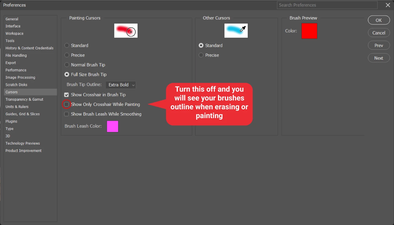

Same issue. If you are using Windows you need to Edit your Preferences and in the Cursor section uncheck Show Only Crosshair While Painting.

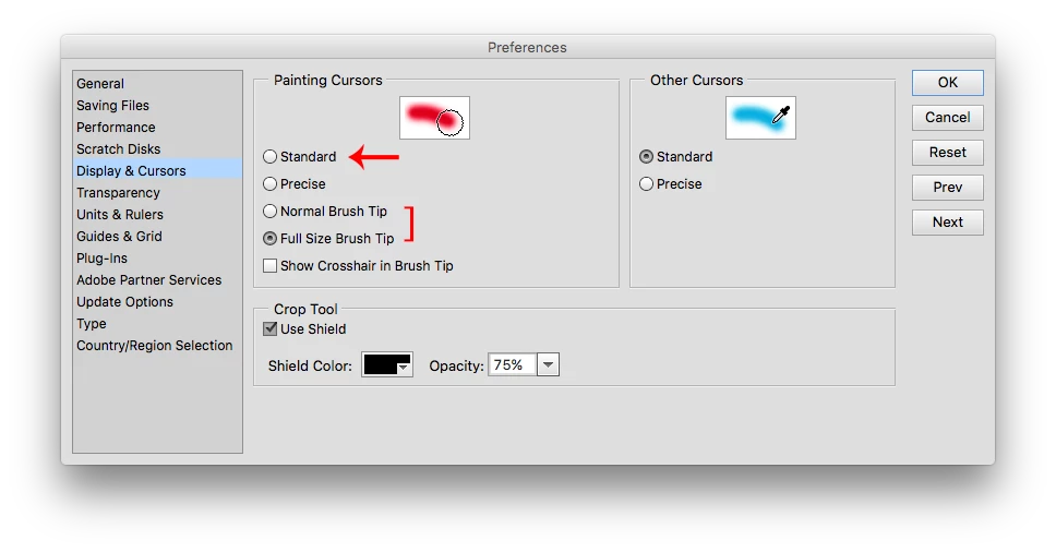

Which version of photoshop elements and operating system are you using?
Sounds like under Preferences>Display & Cursors that Painting Cursors is set to Standard.
Try Normal or Full Size Brush Tip
