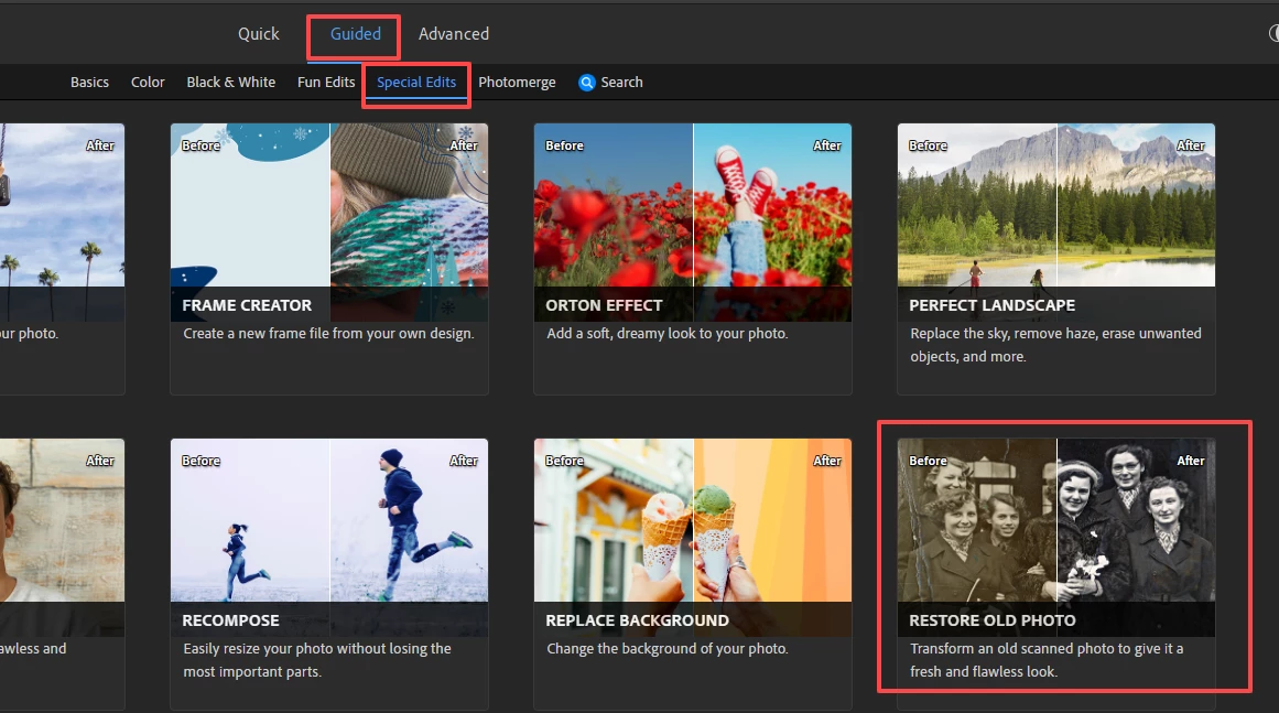

  • To finish the restoration, I suggest using the Perfect Landscape Guided Edit which will walk you through replacing the sky.  You should be able to get something like the following:
Now having gone through all these steps, I have remembered that Elements actually has a Restore Old Photo Guided Edit which will guide you through using these tools and others.
Hope this helps.
