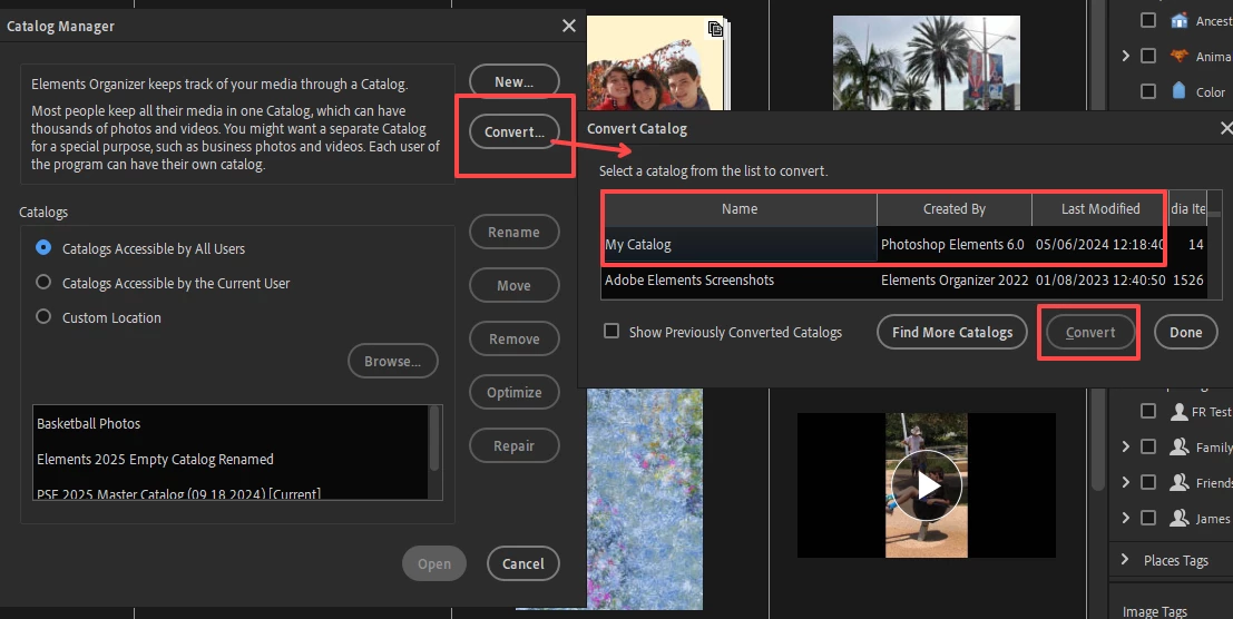

Yes, it is clear what is happening.  Each catalog can only be read by the version of Elements that created it.  Your catalog folders containing the catalog.pse20db files were created in Elements 2022.  You need to convert them to Elements 2025, using the Convert button in the Catalog manager:
5 replies

Some other options for you to consider:
  • If you only have Elements 2025 installed on the new computer, you can double-click on each catalog.pse20db file in Windows File Explorer.  The catalog will be automatically converted and opened in Elements 2025.  (A copy of the old catalog will be created and renamed with a numeric suffix.  That renamed catalog can still be opened in Elements 2022.)
  • If you also have Elements 2022 installed on the new computer, you can right-click on the catalog.pse20db file and use the context menu to Open With>Elements Organizer 2025.

that solved my problem! All catalogues are converted now and are ok. Apparently the catalog manager of 2025 behaves a little different from the one in the previous editions: I was expecting to see all available catalogues in the main window. Upon selecting one the manager would tell that it has to be converted. I never started with pressing the convert button.
Anyway, its done now. Many thanks for your advice!
