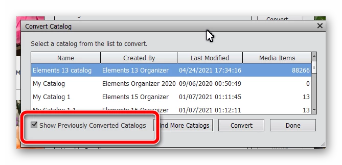

That makes no sense whatsoever.   All Elements 2021 needs is to see the catalog.pse13db file.  More specifically, it will find the folder in which that file is stored.  There are various reasons why Elements didn't see the file in the Convert>navigation dialog. But not having a prior version of the program installed isn't one of them. For example, if the catalog has been converted previously, you need to check a box in the dialog:
In short, I believe whatever you read in the link I provided has not been updated.  So, the references to Elements 13 and 14 in that link are no longer fully relevant.  I was just able to successfully start the conversion of an Elements 13 catalog, using Elements 2021.  The fact that I happen to have Elements 13 installed on my machine would not have made the slightest difference.  I am confident that if I were to uninstall Elements 13, the Elements 2021 conversion would still take place.

Elements 2021 will convert the Elements 13 file. Go to File>Manage Catalogs and use the Convert button.
