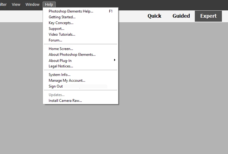

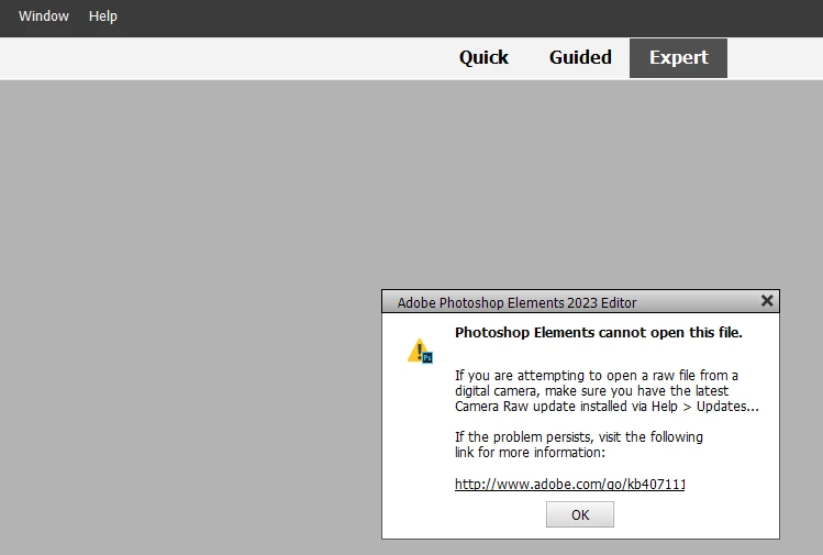

I can't open RAF files from this camera in Elements 2023.  I have the Camera Raw plug-in installed, but it is version 14.4. Adobe cameras support chart says I need version 14.5, how do I get that?  Updates in my Elements is greyed out which I assume means it is all up to date....

Follow the instructions in this workaround:
https://helpx.adobe.com/photoshop-elements/kb/camera-raw-update-not-available.html
You will be able to upgrade to ACR 15.x.
