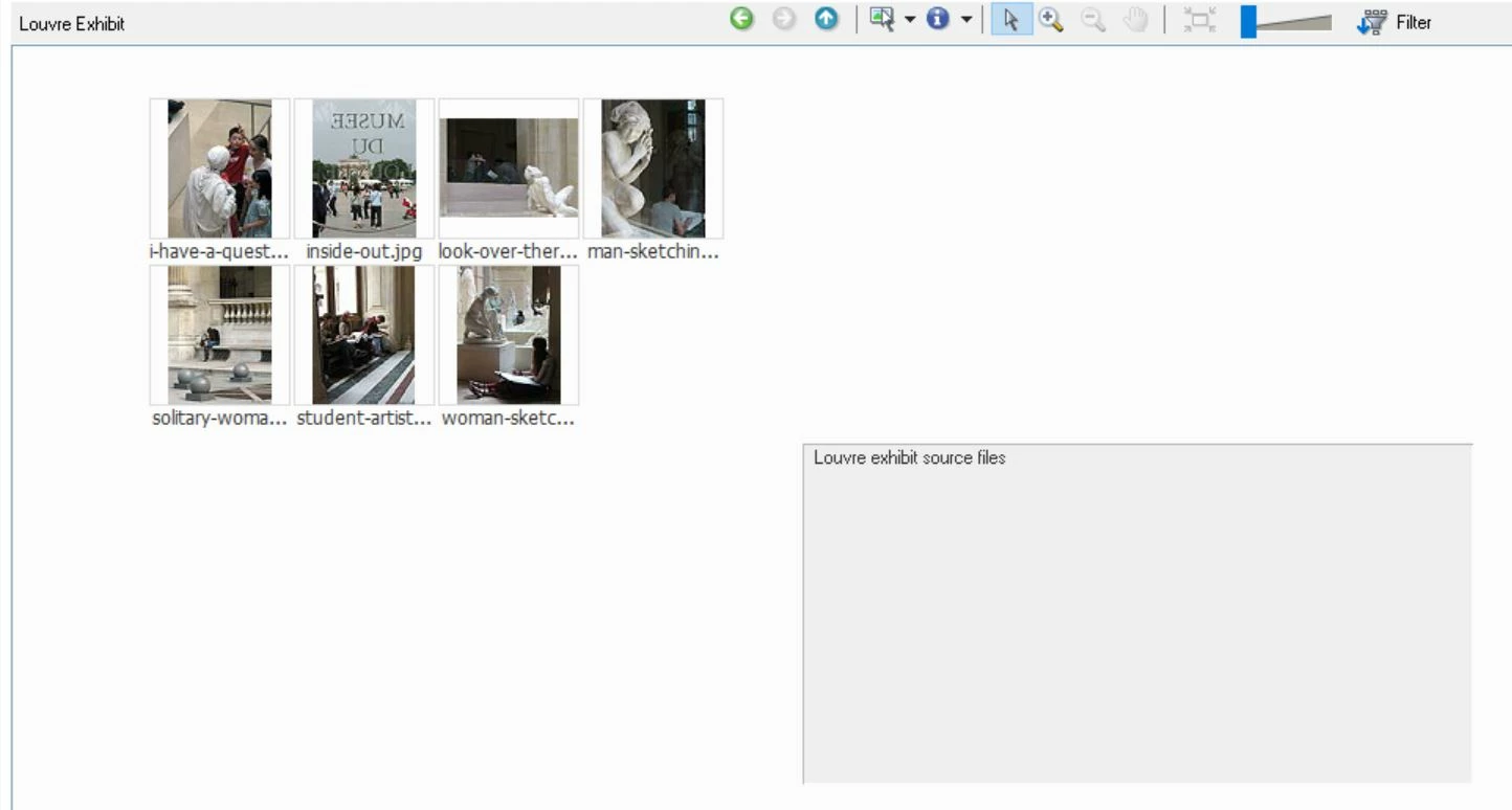

Yes they are. However, .psd are not visible in ZoomBrowser. Hope you enjoy my screen shot. Very proud of those photos.
If you want to delete an entire folder through ZoomBrowser, it will not do so until you manually delete the Photoshop files.
