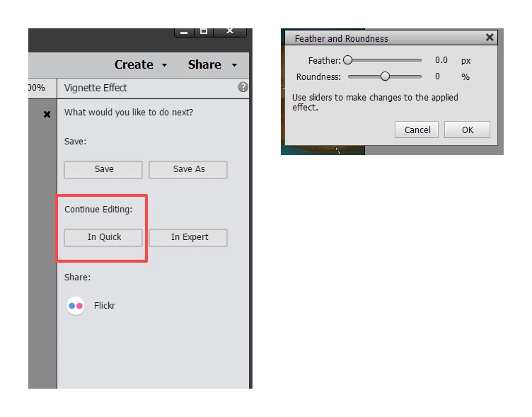

Thanks very much, hatstead. I appreciate the help. However, unless I missed something, when I was done following your instructions,  I just ended up with a black center. Yes, I could fill in the surrounding transparent areas, but the black center stayed.  I used an AI tool to double-check, and it says there might be a missing step. Its instructions (attached) seemed to work.

What functions have you lost in Expert Mode?  I'm guessing that you saw the popup after clicking on the Refine Shape button.  That should have nothing to do with your problem..  But when you finished the Guided Edit, you probably clicked on the Next button, you would be asked how you wish to continue, and you probably chose to go to Quick Mode instead of Expert Mode.   Quick Mode only has limited editing functionality.  All you need do is click on the Expert Tab at the top of the screen.  If my guess is incorrect, please give us more details.
BadStarAuthor
Oct 31, 2024 11:45 PM UTC
Thanks Greg. (Thought I posted this earlier.) I did not choose the Quick mode. What I did was in the "Guided" mode when I was done with the vignette I went to the top left in the toolbar and chose File>Save Then when I clicked on Expert at the top I got the Cancel/Discard/Save popup. This confused me as I felt I had just saved it, so I probably chose "Discard."
The dysfunctionality is that all the layers do not respond at all. I am able to open a new layer though and was able to add text with it. But now that I know just to go from Guided to Expert I'll have no problems. (Plus, I've been experimenting, I see I can save the changes in Guided and then choose not to save them in Expert.) All good. Thank you.
