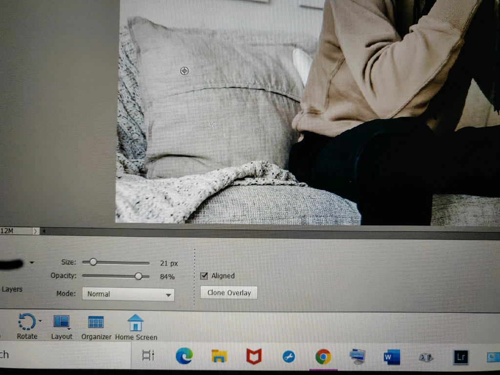

I am having problem with my clone stamp. I have Photoshop elements 2020.
Clone stamp functions well with my left side alt+click of the keyboard.

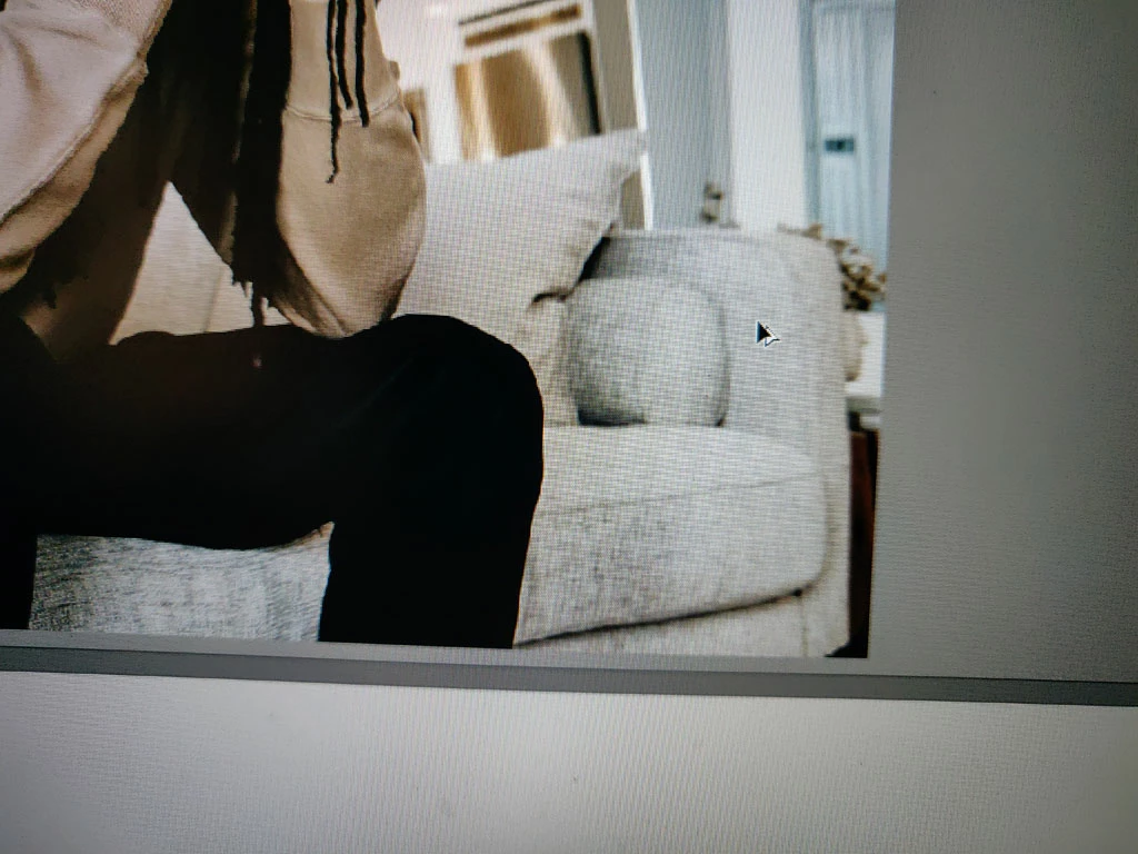

On the right side of key board, if I press alt+click, I get a black arrow head symbol as shown in the attachment.

Unfortunately, holding down the Alt Gr key on its own is essentially the same as holding down Ctrl + Alt, so that's why @mickams is seeing the cursor change to the copy + move cursor, as Ctrl+Alt is the keyboard shortcut for that function.

As I told you earlier only the left alt key functions well with clone stamp while rt one shows the double arrow head symbol.
I get double arrow head symbol the moment I press just alt key on left side of key board.I don't even add -click
