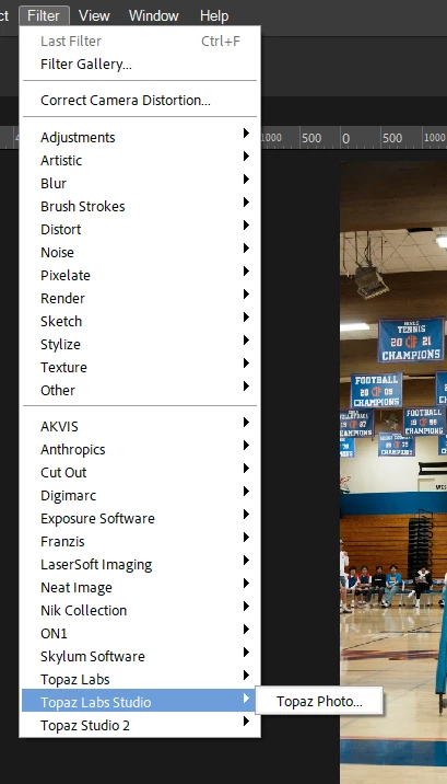

Topaz should have automatically installed the plug-in into Elements.  With a file open in the Editor, go to the Filter>Topaz Labs Studio menu and you should find Topaz Studio.  Let me know if you don't see it and I will give you an alternative method to access it.  Also, which version of Topaz Studio do you have?

I found topaz in the filter pull down.  I can open a jpeg in PE and then denoise and sharpen it in topaz.  That works.
I was expecting I would denoise the nef file then edit it in camera raw then edit it in PE but maybe that can't be done. It seems like I have to edit in camera raw, open the file in PE, denoise with topaz and then edit in PE.   I tried again to make a topaz dng and open it in camera raw and it failed.  Somehow you have it working.  It is my understanding that everyone uses topaz first and then starts editing in camera raw and then in PE so I was expecting to do that but maybe I have that wrong.

stupid question but how do I access topaz as a plug-in?  I don't see an option for that.  Maybe there is a link to a tutorial.
