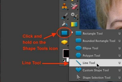

    Pressing the N key in the Editor usually brings up the pencil tool.
    Other options exist with the shape tools (see image below) including a line tool. The custom shapes include arrows which can be dragged to any length and can also be rotated.
